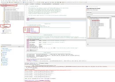

Dear NXP technical support team
I want to proceed with the project using S32K312. First time using S32K312.
So, I am studying using the example project.
I installed and compiled the S32K RTD AUTOSAR 4.4 Version 2.0.0 D2203 example project on the homepage.
However, compiling causes errors.
The contents are as shown in the picture below.
Please let me know why this error occurs.
and How can I use the example project?
Do you have any reference notes on sequential methods of using examples?
thank you.

Hi@JH_ZHANG
please click "Update Code" and then build it again,
