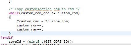

459021854
Hi, Edward
I think because in c  file     "   startup.c    "  there is code to  copy code from FLASH to RAM,
that's not I wanted. I do not want any COPY happened, because i do not want a copy of flash driver be placed in flash.   just want only one flash driver directly be  placed in RAM.
PLEASE,  still need help.
