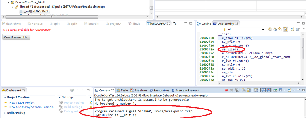

hello, Stanislav Sliva
I have tested it.but i find a problem which is it can run well in debug,when i take off the MULTILINK UNIVERSAL, and reset the board ,it cannot work normal,can you help me?
i find that if the VMA is different from the LMA, it happens. when the VMA(in ram) is different form LMA(in rom),the s32 will show "Program received signal SIGTRAP, Trace/breakpoint trap.",and go on running by F8 is pressed. if the MULTILINK UNIVERSAL is removed,it can not run normal in run mode.
The facts are as follows:
The MCU is mpc5746c.the ide is S32 Design Studio for Power Architecture Version: 1.2
In debug mode, the problem is as follow figure:
when  the code which is " e_bl main" is run,it run _eabi first before into main.During the process , "program received  signal SIGTRAP..." happens.
The program can go on running ,when the "resume button " is pressed on.But if I take off the MULTILINK UNIVERSAL,and reset the board,the program
can not runinto main,it is suspendend maybe.  when the VMA is the same as LMA in the rom, the problem never happen.i think that the reason is se_illegal but how can i do to avoid it ? help me,help you ,thank you!

The same experienced using S32 Studio for powerpc v1.2; even easier way to reproduce:

Generated disassembly on main entrypoint (main >> __eabi >> __init)
00004438 <__init>:
4438: 18 21 06 f0 e_stwu r1,-16(r1)
443c: 00 80 se_mflr r0
443e: 54 01 00 14 e_stw r0,20(r1)
4442: 00 00 se_illegal
4444: 79 ff fc ad e_bl 40f0 <frame_dummy>
4448: 79 ff fd b9 e_bl 4200 <__do_global_ctors_aux>
444c: 50 01 00 14 e_lwz r0,20(r1)
4450: 00 90 se_mtlr r0
4452: 20 f1 se_addi r1,16
4454: 00 04 se_blr
4456: 50 01 18 21 e_lwz r0,0(r1)
It seems that long call triggers a wrong alignment on the init trampoline; the problem happens both with Debug/Release (flash) targets (on Debug_RAM code is already in ram, the problem is not triggered).
I hope it helps.

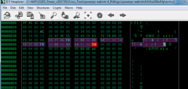

To fix this problem I did try to modify the library file.
From the output.map file we can find what library file used as __init section.
like..
.init 0x000119c4 0xc c:/nxp/s32ds_power_v2017.r1/cross_tools/powerpc-eabivle-4_9/bin/../lib/gcc/powerpc-eabivle/4.9.4/e200z4/fp/ecrti.o
0x000119c4 __init
Find the library file (my case is ecrti.o)
and manually modify to find "18 21 06 F0 00 80 54 01 00 14 00 00 " - in my case, 2 of part exists. need to modify all of those.
To "18 21 06 F0 00 80 00 80 54 01 00 14"  - 00 80 inserted.
This is the part of
__init
 e_stwu r1,-16(r1)
 se_mflr r0
 e_stw r0,20(r1)
 se_illegal <---- 0x00, 0x00
To
__init
 e_stwu r1,-16(r1)
 se_mflr r0
 se_mflr r0 <--- insert this repeated from just before, value = 0x00, 0x08
 e_stw r0,20(r1)  <--- 2byte shifted, value = 0x54010014
This modification works in my experiment. for Debug, Release both of object.
I hope it helps,

Dear Xiaoxi,
I only needed to change ecrti.o as shown in the picture
Although this work-around works, I still wonder what the root-cause is...
Regards, Folkert
