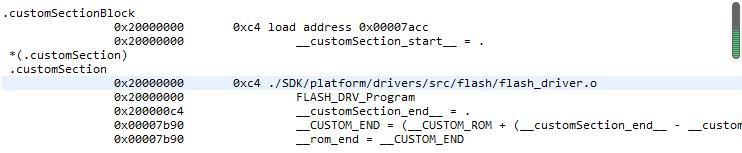

Hi, experts:
please do me a favor, when I develop a bootloader.  I need  separate Flash driver  with the other parts of bootloader code to different places.
Flash driver, such as FLASH_DRV_Program, should be compiled as a separate .src file and be  placed at RAM.
other parts of bootloader code should be placed in the flash.
I have tryed   __attribute__((section (".customSection")))
status_t __attribute__((section (".customSection"))) FLASH_DRV_Program(const flash_ssd_config_t * pSSDConfig,
uint32_t dest,
uint32_t size,
const uint8_t * pData)
but in .map  the result turn out to be 360截图20200924162616978.jpg360截图20200924162616978.jpg
this means  function FLASH_DRV_Program is loaded from address 0x00007acc to address 0x20000000, NOT I want.
I just want FLASH_DRV_Program is directly placed in RAM by compiler, NOT loaded from flash.
If the flash driver which placed in RAM be compiler as a separate .src,  that's better.
How can I solve those problem?  please help me, much appreciated. my MCU is S32K144.

kef2
Senior Contributor V
I'm not expert of GCC linker scripts, but as I understand it ": AT(xx)" in linker file instructs section to be loaded from xx.
  .code : AT(__CODE_ROM)
    . = ALIGN(4);
    __CODE_RAM = .;
    __code_start__ = .;      /* Create a global symbol at code start. */
    *(.code_ram)             /* Custom section for storing code in RAM */
    . = ALIGN(4);
    __code_end__ = .;        /* Define a global symbol at code end. */
  } > m_data
__CODE_ROM is a location in flash while m_data is RAM. So try removing : AT(xx) and see.

459021854
Hi, Edward
I have tryed your method that's not working.360截图20200924173725845.jpg360截图20200924173725845.jpg
I think because in c  file     "   startup.c    "  there is code to  copy code from FLASH to RAM,
that's not I wanted. I do not want any COPY happened, because i do not want a copy of flash driver be placed in flash.   just want only one flash driver directly be  placed in RAM.
PLEASE,  still need help.
