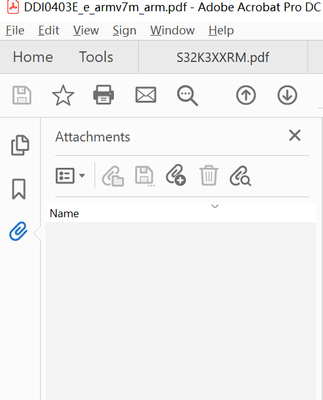

5,035 Views
Sylvia_jiang
Hi Daniel,
            ARMv7-M Architecture Reference Manual.pdf has been downloaded successfully. But attachments are null.
5,030 Views
danielmartynek
I'm sorry, the excel is attached to the S32K3xx RM because this is vendor specific unlike the description of the registers that can be found in the ARM documentation.
