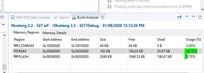

olimexsmart
Thanks, but doing something simple like ST does?
3,824 Views
davidtosenovjan
Unfortunately, such feature is not available.
