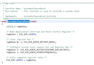

There is also this function in the system_S32K144.c file:
