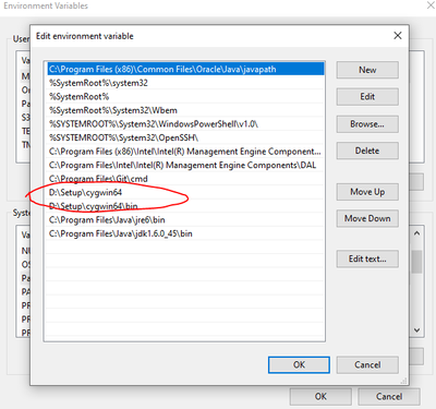

It seems like you haven't installed any GNU make yet. You can install the GNU make here: https://www.gnu.org/software/make/ or install Cygwin https://www.cygwin.com/ then add the make.exe directory to your PATH variable.
Nam
9,301 Views
lb28
The 'Path' variable in what application?
9,293 Views
namnguyenviet
Sorry I didn't make it clear. It's the PATH in environment variables. Something like:
Here is a link that you can refer to:
https://docs.microsoft.com/en-us/previous-versions/office/developer/sharepoint-2010/ee537574(v=offic...
Nam

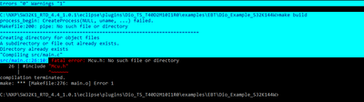

I am now getting this error.
9,277 Views
namnguyenviet

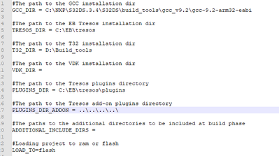

Sometimes the slash in the path might be the problem. Usually  backslash is used path to a local file on a windows machine, while slash is a path to a web resource or file located on a UNIX based machine (includes Macs, Linux).
Try to change the slash in project_parameters.mk and see whether your issue can be fixed.
Nam
9,269 Views
lb28
I'm getting the same error again.
Here's my project_parameters.mk file.
9,245 Views
namnguyenviet
Hello @lb28,
Is it indeed that the path to the Tresos plugin directory (where you've installed the RTD package) is C:\EB\tresos\plugin?
Nam
9,240 Views
lb28
Ahhh,
I updated the path, thank you
