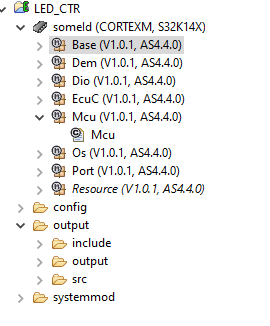

I've configured modules in EB Tresos and have generated a project for S32K14W-Q064 Evaluation Board
I tried following these following steps, however I am having no luck.
Can I somehow use S32 DS to generate a .elf file and flash it onto my board?

Hello @lb28,
Is it indeed that the path to the Tresos plugin directory (where you've installed the RTD package) is C:\EB\tresos\plugin
Nam
