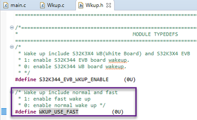

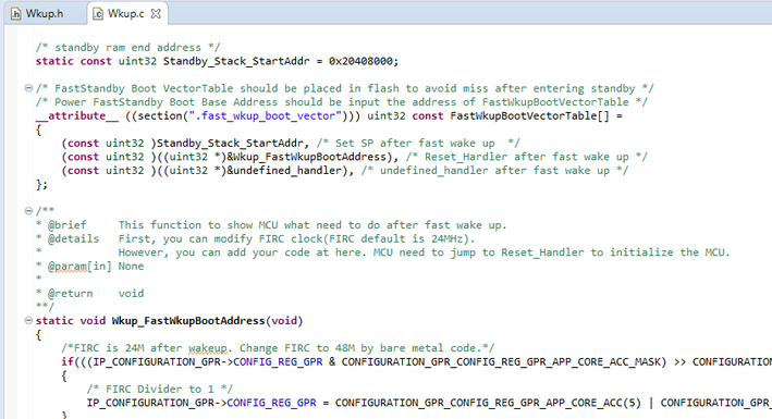

The examples have fast wakeup too.
For instance, S32K344_GPIO_Wkup_S32DS_3_4_RTD_LLD_2_0.zip
include/Wkup.h
src/Wkup.c

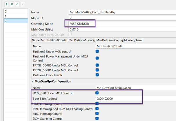

have configured boot base address 0x00402000 in MCU for standby wakeup and also updating linker with below info.
After adding  KEEP(*(.fast_wkup_boot_vector)) in .pflash getting error mentioned above.
How i can adjust size in this linker.  ?

To enable Fast Wakeup, you must configure the boot address, which sets the entry point after wakeup.
This configuration is done by writing to the DCMRWF5 register, where you specify the base address of your custom vector table in standby SRAM and enable the Fast Wakeup mechanism.
BR, Daniel

aryandis
standby wakeup working but i need for for faststadnby wakeup .
here i have done memory map.
.fast_wakp_boot_vector
0x20400000  0x0c load address 0x00402000
0x20400000    .= ALIGN(0x1000)
