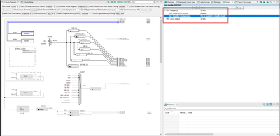

 The purpose of this demo application is to present a usage of the
 POWER & WKUP IP Driver for the S32K3xx MCU.
In current example :--
SW-6 = PTB-19 -----> PRESS to enter the STANDBY mode.
SW-5 = PTB-26 = WKUP[41] --> PRESS to exit the STANDBY mode.
RTC --> Wakeup source-1
The example uses PIT-0 timer, to generate the periodic interrupt.
T
* Test HW: S32K3X2EVB-Q172
* MCU: S32K312
* Compiler: S32DS3.5
* SDK release: RTD 3.0.0
* Debugger: PE micro
* Target: internal_FLASH
Make following settings, SIRC enabled in Standby mode :--
