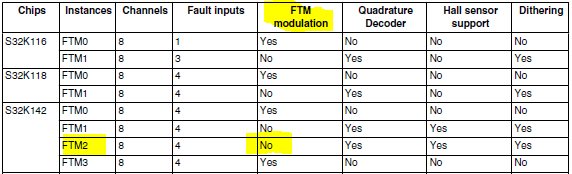

Hello all,
I'm trying to develop a PWM modulation with FTM2 for the S32K142 device. But it looks like the modulation doesn't work for FTM2 as per the below screenshot.
Kindly confirm the same.
RAJU

Hi BJ RAJENDRANATH,
I have check it in the latest S32K1xx MCU Family - Reference Manual (REV 12.1).
Still get the same information as the table that you found.
And I can only find the FTM0_OUTSEL and FTM3_OUTSEL bit.
Robin

Hi Robin,
Thanks for your swift response & it's really helpful.
As suggested, does it mean I can use only Channel1 alone (FTM1-CH1 & FTM2-CH1) or all FTM channels from CH0-CH7.
In other words, If I initialize FTMOPT1->FTM3_OUTSEL=0xFF; I can implement all FTM1CH0-7 signals withour initializing FTM0.
