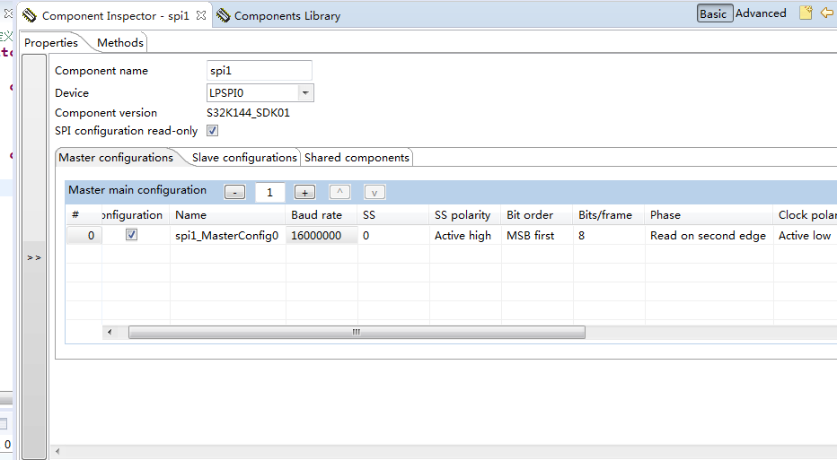

Hello, I now need to configure the SPI rate of S32K148 to 80MHz, but I can't. I'd like to ask how many M can be configured for SPI and how to set it.SDK can only configure 0-16Mhz at most

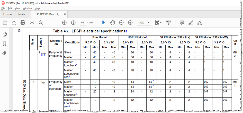

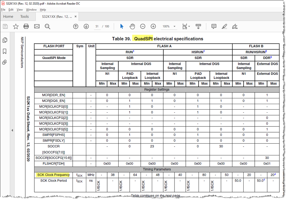

Maybe you should use SPI module instead of use LPSPI.
The electrical specifications can be found in datasheet.
