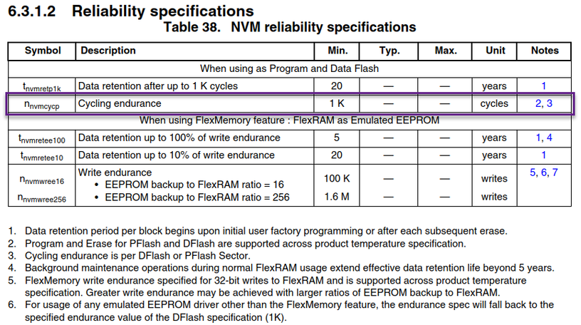

问题:
      压力升级测试6W次,开始偶现FLASH擦除失败问题。 复现概率1/300
      擦除使用库函数 address = const 0x0000e000U,size = const 0x32000U:
     出现问题ret不为seccess。
    现在急需想寻求帮,flash可编程最大次数为? S32K-RM.pdf中是否有相关说明,如果有请指出。
谢谢。

Question:
The pressure upgrade test was conducted for 6W times, and the flash erase failure problem began to occur occasionally. Recurrence probability 1/300
Erase using library function address=const 0x0000e000U, size=const 0x32000U:
When there is a problem, ret is not second.
Now we need help urgently. What is the maximum number of times flash can be programmed? Whether there are relevant instructions in S32K-RM.pdf. If yes, please indicate.
thank you.

Hello @sunxiaoyi,
How many times did you erase the sectors?
Cycling endurance is guaranteed up to 1k cycles.
