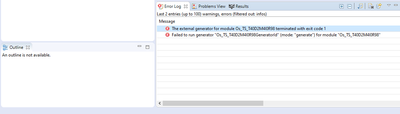

I installed tresos Studio 23.0 , Autosar OS(SW32K14-OS401-RTM-1.0.0 b4.0.98)  and Autosar MCAL(SW32K14-MCAL401-RTMC-1.0.4).
But when I try to generate OS configuration file(.c,.h), it gives the following 3 error:
1.The external generator for module Os_TS_T40D2M4I0R98 terminated with exit code 7
Used generator commandline: C:\EB\tresos\plugins\Os_TS_T40D2M4I0R98\ssc\bin\generator\sg.exe
2.Failed to run generator "Os_TS_T40D2M4I0R98GeneratorId" (mode: "verify") for module "Os_TS_T40D2M4I0R98"
3. Error in external generator: C:\EB\tresos\workspace\oooooll\output\generated\epc\project.epc(1816) AUTOSAR/AR-PACKAGES/AR-PACKAGE[SHORT-NAME='Os']/ELEMENTS/ECUC-MODULE-CONFIGURATION-VALUES[SHORT-NAME='Os']/CONTAINERS/ECUC-CONTAINER-VALUE[SHORT-NAME='Task_Environ']/REFERENCE-VALUES/ECUC-REFERENCE-VALUE[DEFINITION-REF='/TS_T40D2M4I0R98/Os/OsTask/OsTaskEventRef']: 3254: Multiplicity check error for 'VALUE-REF'
I want to what's the problem reason? and how to resolve it?

My AUTOSAR OS is 4.0.98 ,EB is 21.0.0,try above these answers,not to solve it , but I try to uninstall 21.0.0 then install EB 24.0.1 is not show the two errors.

Oh,Sorry,above answer can't to solve this problem .With the help of my master, we have tried multiple times and found that the JRE environment has not been installed

It seem that you haven't added the value for the OsTaskEvenRef in the configuration. Could you please try to add it.
Note that user also need to add atleast one element in the OsEvent to make the list show in the OsTaskEvenRef
