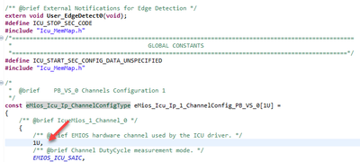

Are you utilizing the example from the RTD, or are you implementing the configuration in a new project? If you are using the example, please take into consideration which channel was initialized:
Also, the function states the following: Emios_Icu_Ip_Init must be called before. The given channel must be configured in Measurement Mode Signal Measurement, Duty Cycle Values.

the value is not updating in icuipgetdutycyclevalue function .
