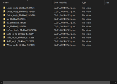

Julián_AragónM
Hi @James123,
You can find the Emios_Icu_Ip_BlinkLed_S32K344 example under the following installation path for the RTD:
  • C:\nxp\SW32K3_S32M27x_RTD_R21-11_4.0.0\eclipse\plugins\Icu_TS_T40D34M40I0R0\examples\S32DS\S32K3XX
With the following examples as well:
This example controls with input in ICU-eMios pin through IcuSignalNotification function, a GPIO trigger will generate edges to ICU input pins. The interrupts will be generated for the ICU channels and the user's functions will be called; the user's functions will blink LED.
Hope you find this helpful!
Julián.

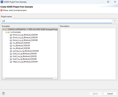

Julián_AragónM
Hi @James123
This example is found under the RTD installation path. If you have the latest RTD installed, you can import the example instead from Design Studio:
As for the functions, you can try to implement Emios_Icu_Ip_GetDutyCycleValues, this function reads the coherent active time and period time for the given ICU Channel.
Hope you find this helpful.
Julián

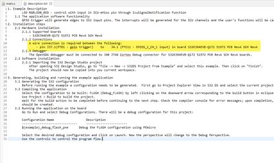

abdul_rahman
Hi @Julián_AragónM
This SAIC example code is not working. The Red LED of the S32K3X4EVB-T172 evaluation board is not blinking according to the given program. Can you send me the working version of this example code for the board I'm using?
8,135 Views
Julián_AragónM
Hi @abdul_rahman,
Have you connected the GPIO trigger and channel 1 for EMIOS?
Julián
8,125 Views
abdul_rahman
Hi @Julián_AragónM
Must've slipped my eye about connecting the pins. The code is working fine now. Thanks for the help.
