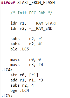

The SRAM ECC is initialized in the startup_S32K144.S file and this is done by 32b writes.
I was able to reproduce your test results only when I removed the ECC initialization.
I don't know which version of S32DS you are using.
As far as I know, the first version of the startup code didn't include the ECC initialization, it was added later.

thank You! I started from creating new "S32DS Project from Example". Example projects seem being not updated and  use old startup files. Creating new "S32DS Application Project" I see what you provided in startup*.S file.
Initializing only used locations could make startup bit faster. As well ECC handler could be used to detect unexpected accesses to locations which shouldn't be used (not initialized locations)... But initializing all available RAM is quite good as well.
