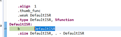

I am getting following error when i do debugging, and execution of code is stuck at following DefaultISR . Getting this error :--
Initializing.
Target has been RESET and is active.
BusFault: A precise (synchronous) data access error has occurred.
Possible BusFault location: 0x4004C03C.
HardFault: A fault has been escalated to a hard fault.

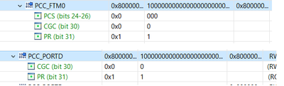

Then i check the clock settings for PORT-D & FTM-0. And found that clock is not set :---
Following register PCC_PORTD & PCC_FTM0, bit-30 CGC is ZERO.
Inspite of initializing my system clock this clocks are not set :--

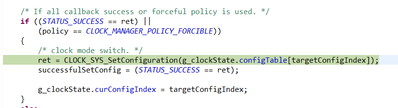

What i found following function call return status : STATUS_ERROR :----
CLOCK_SYS_UpdateConfiguration()
Inside this function following line gives error :--
ret = CLOCK_SYS_SetConfiguration(g_clockState.configTable[targetConfigIndex]);
It seems some issue with my configuration of clock that's why this function failing :--
Please suggest what I have made wrong settings, so that i can resolve this error.

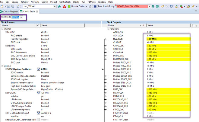

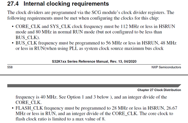

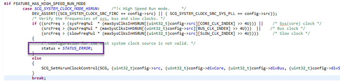

The CLOCK_SYS_UpdateConfiguration() function returns STATUS_ERROR here:
clock_S32K1xx.c
If you open HSRUN configuration, you will see that the system clock frequency in your HSRUN configuration does not meet the max allowed values.
