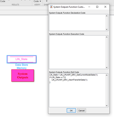

I've followed the LIN Master and Slave examples for the NXP S32K144 EVB, connected the wires according to the description in the examples. The communication is all good between Master and Slave.
But, when I disconnect a LIN wire and plug it back in, the communication stops completely. Is there a way to restore the communication back again without manual power reset?

Hello @saranya_chitta ,
MBDT generates code on top of the S32SDK for S32K. There are a couple of C functions that can be used besides or block, solving some issues like the ones you see with your board.
For example you can get the LIN state using the following function
lin_node_state_t LIN_DRV_GetCurrentNodeState(uint32_t instance)
and also, you can abort a transfer (which works for the CAN, see below) using the following function:
status_t LIN_DRV_AbortTransferData(uint32_t instance).
Please give this a try and let me know if worked.
A similar discussion we had previously on CAN, please have a look at the link below. This might be a good tutorial for getting the same results on LIN.https://community.nxp.com/t5/Model-Based-Design-Toolbox-MBDT/Reset-CAN-Bus-Silence/m-p/1190321
Hope this helps,
Marius

I set the data store class as volatile
Thank you @mariuslucianand
I looked at the other thread and implemented something similar. This worked around our issue with LIN communication.

saranya_chitta
I've tried to replicate the same as you mentioned by following the URL you've shared and I see the communication is restored now without a power reset (when I intentionally pull the LIN wire and plug it back in). The attached example in the other thread was helpful.
Appreciate your help!
