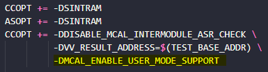

Hello There,
I'm looking for Clock Monitoring Unit Examples in K358. Tried seeing those in RTD, CMU features are not Implemented in the Examples. I configure these in EB Tresos Studio, I'm not sure about the correct way of enabling CMU
In MCAL MCU drivers. In Port->Mcu
1.MCU generalConfiguration:
                                                    McuEnableUSERmodeSuppoer-> Enabled
                                                    McuCmuNotification ->Enabled
 1.a)MCU ModuleConfiguration:
                                                    ClockFailure Notification-> Enabled
2.MCUClockSettingsconfig : Mcuclkmonitor
                                                   McuClkMonitor_0->Enabled
                                                   McuClkMonitor_1->Enabled
                                                   McuClkMonitor_2->Enabled
Still facing Some compilation switch macro errors.
CLOCK_IP_ENABLE_USER_MODE_SUPPORT,
CLOCK_IP_REGISTER_VALUES_OPTIMIZATION and
CLOCK_IP_CMU_FC_FCE_REF_CNT_LFREF_HFREF_TRUSTED_CALL.
Kindly give some suggestion on this.

Hi P_S7,
Did you add  "MCAL_ENABLE_USER_MODE_SUPPORT" into the makefile?
Dan

Hi @DanNguyenDuy,
I enabled this macro using EBT Studio.

Hi P_S7,
Follow the UM file, you need to add this macro to the makefile.
