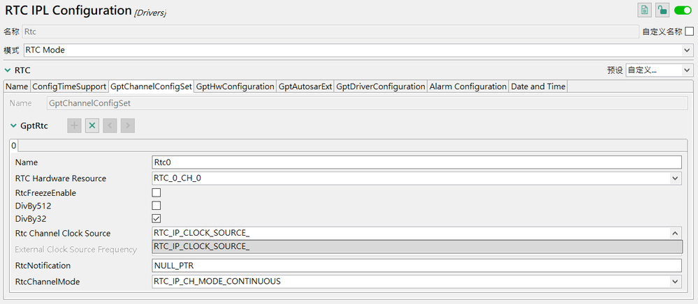

Hellow, I have created RTC function. RTC clock source uses external OSC (32.768k).
When opening the RTC driver UI window, the "RTC channel clock source" flag cannot be selected. It just shows "RTC_IP_CLOCK_SOURCE_".
How do i setup items and functions?
Used the SDK  "PlatformSDK_S32K3_2022_07_S32K324"
The clock source could be select source_0, source_1, source_2, source_3The clock source could be select source_0, source_1, source_2, source_3

Reset the CLK Setting in Run mode will fixed the issue. The "RTC Channel Clock Source" Item can setup to source_1

Senlent
Hi@Foxconn
There may be some differences between this place and the old version,
When you select the specified clock for RTC in the clock configuration page, this option will not be changed.
for example:
