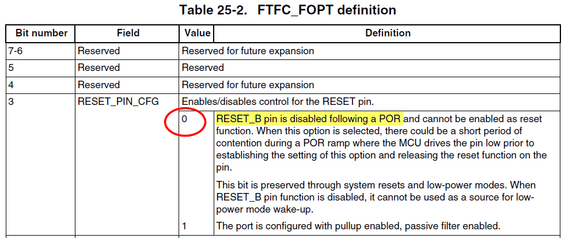

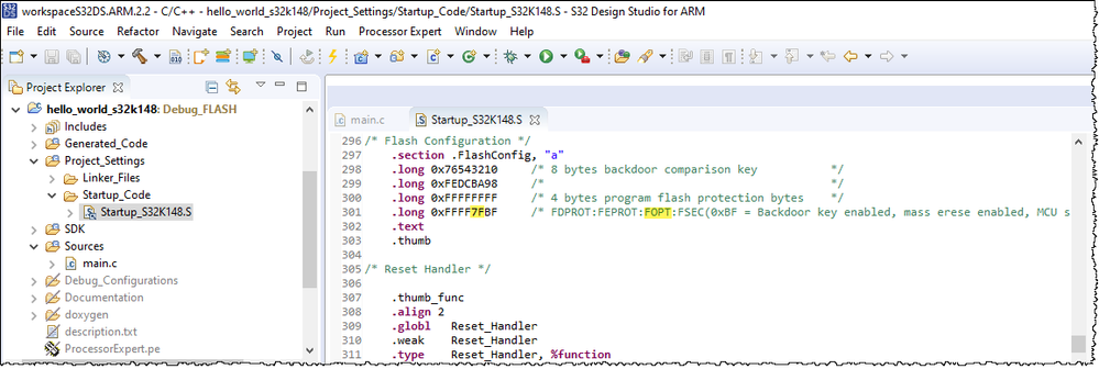

Please change the Flash Configuration in Startup_S32K148.S
The default value of FOPT is 7F, since you want to clear bit 3 RESET_PIN_CFG, please change it to 77.

m_mishrikey
I tested, and this solution works.
I wish I understood better though.  When I checked the emb_sys register the FOPT was 0x00 which should have disabled it.
I guess the startup behavior is different though, and it is governed by this startup_S32K148.S?   Is there some documentation about using this file?  I don't think I ever would have figured it out with your help.

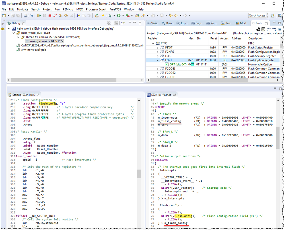

Robin_Shen
Flash Configuration block : 16-byte flash configuration field that stores default protection settings (loaded on reset) and security information that allows the MCU to restrict access to the Flash Memory module.  Placed at address 0x400 by the linker script.
