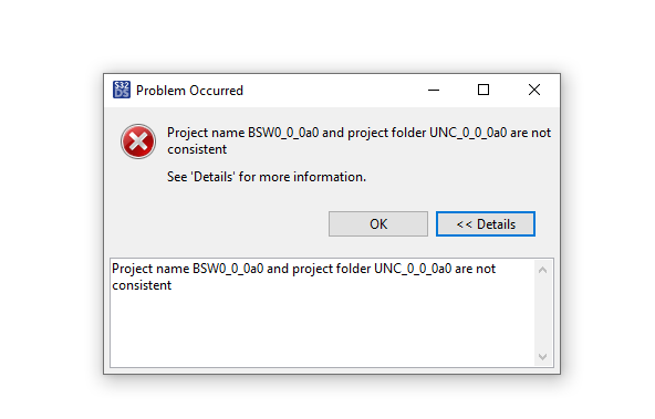

Hi everyone,
I want to rename my project from 'UNC_0_0_0a0' to 'UNC_1_0_0a0', but it gives me this error.
'BSW0_0_0a0' was the name of the original project from which I started to develop the current one.
The project is already in the workspace, since I've read that otherwise the renaming won't be possible,
but it doesn't work anyway.
I don't know what to do, anyone can help me?
Thanks in advance.
Giacomo

Nevermind, I found  a solution.
I had to modify the project name in the ".project" file, contained in the project folder.
Once I aligned it with my folder name (from BSW0_0_0a0 to UNC_0_0_0a0) I was able to
rename it again, using the Rename command.
Hope this will be helpful for someone.
Giacomo
