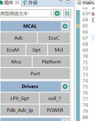

I try to build a ADC project triggered by pdb using s32ds with autosar mcal,whether just the mcal module ADC is needed,should the drivers module Adc_Ip and pdb_Adc_Ip is needed? thanks

cuongnguyenphu
If you added Adc in MCAL module, don't need to add PDB_Adc_Ip under Driver layer

thinks for your replying,I want the pdb trigger by Lpit ,but in mcal ADC module,i can not configure the pdb to trigger by hardware,it seems that pdb  can only triggered by software.My ultimate aim is just using mcal to configure a project that adc is triggered by pdb ,and pdb is triggered by Lpit.
