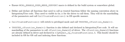

namnguyenviet
It looks like you haven't defined the OsIf_Trusted_Call_Return, or the definition was somehow misinterpreted. Here is the guidance to implement the user-mode in autosar OS (it's noted in RTD 2.0.2 and above):
Nam
