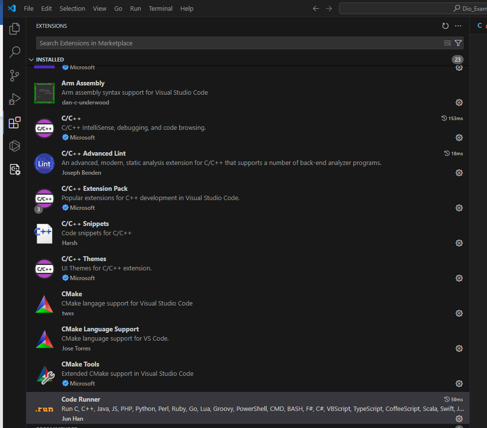

Here are some installation plug-ins I often use:
Fig 1
Fig 2
You can search in extensions and install it directly.

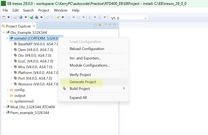

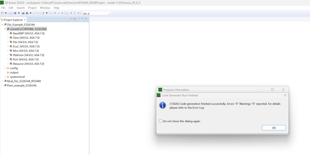

Double-click someId, then right-click. If you do not need to make custom configurations, just click generate project. Wait for the generation to complete without errors and close the EB IDE.
Fig 4

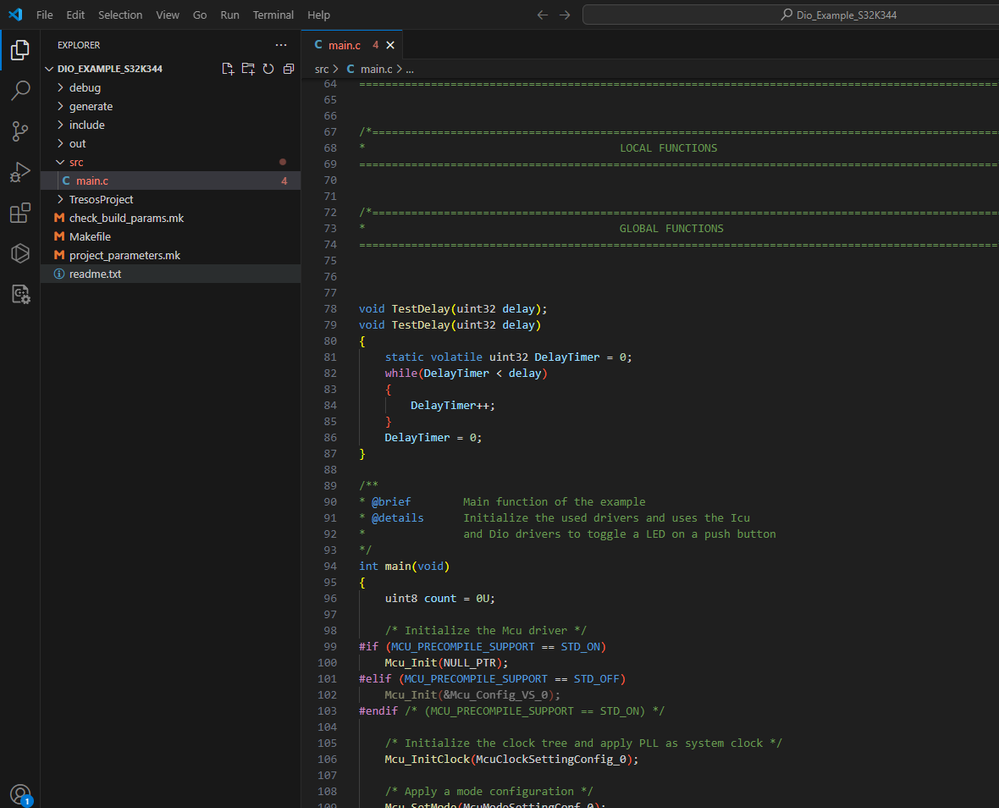

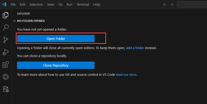

2.2 VScode  open project
   First open VScode and select the project path in open Folder:
C:\NXP\SW32K3_S32M27x_RTD_R21-11_4.0.0\eclipse\plugins\Dio_TS_T40D34M40I0R0_vscode\examples\EBT\S32K3XX\Dio_Example_S32K344
Fig 5
After opening, you can see that all the files in the path have been put in:
Fig 6
You can save the workspace so you don't need to open the folder every time.

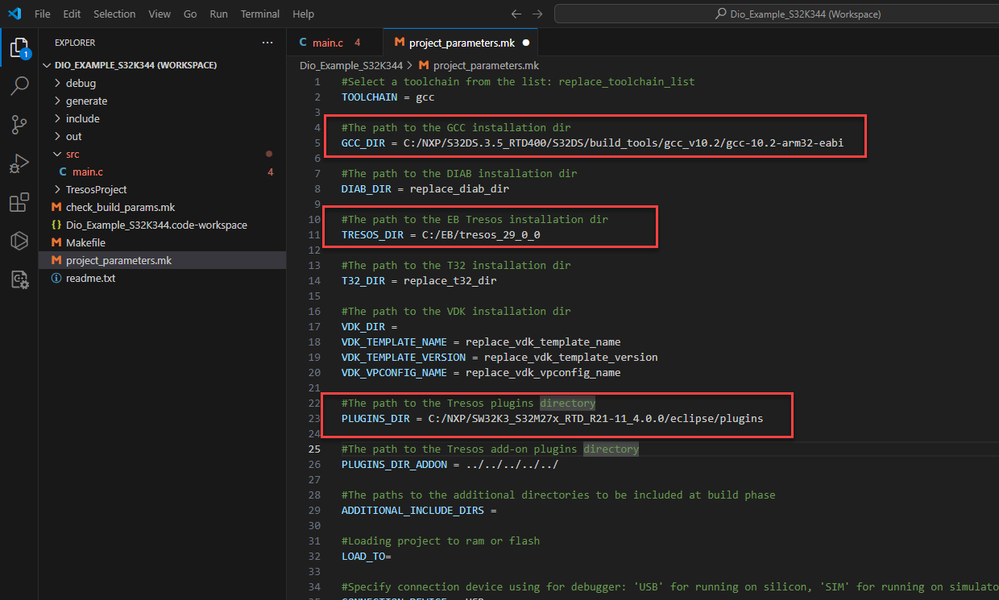

2.3 Modify mk file
The project mk file needs to be modified to specify gcc, tresos paths, etc.
Modify points:project_parameters.mk
GCC_DIR = C:/NXP/S32DS.3.5_RTD400/S32DS/build_tools/gcc_v10.2/gcc-10.2-arm32-eabi
TRESOS_DIR = C:/EB/tresos_29_0_0
PLUGINS_DIR = C:/NXP/SW32K3_S32M27x_RTD_R21-11_4.0.0/eclipse/plugins
Fig 7

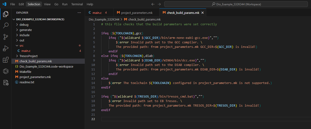

Modify points: check_build_params.mk
Delete
ifeq ("$(wildcard $(T32_DIR)/bin/windows/t32marm.exe)","")
    $(error Invalid path set to Trace32. \
    The provided path: from project_parameters.mk T32_DIR=$(T32_DIR) is invalid!)
Endif
Fig 8
Then save all files:File->save all

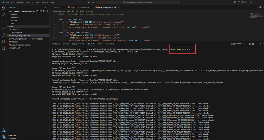

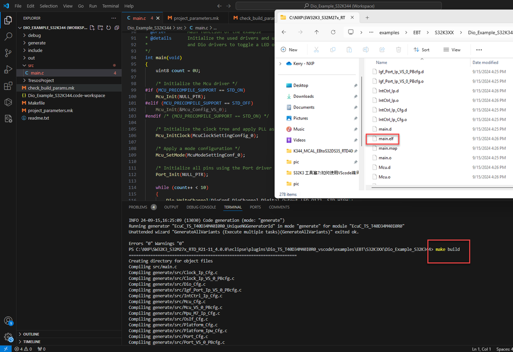

2.4 Compile the file
Terminal->New Terminal
Enter the following command:
>make generate
>make build
Fig 9
Fig 10
As you can see, after make build, an elf file has been generated in the out folder.

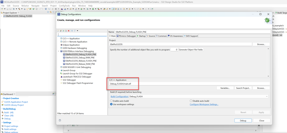

2.5 debug the generated elf file
Since the S32K344-EVB has an onboard opensda tool, we directly use the S32DS empty project to link to the generated main.elf file to download and debug.
Create a new S32DS project, and the interface is PE Multilink, then directly change the elf file to main.elf in the debug configuration, and then put the previously generated elf file into the folder of the new S32DS project:
\Debug_FLASH
Fig 11
Then, enter debug mode, the results are as follows:
Fig 12
As you can see, the chip has entered debug mode and can run successfully.
