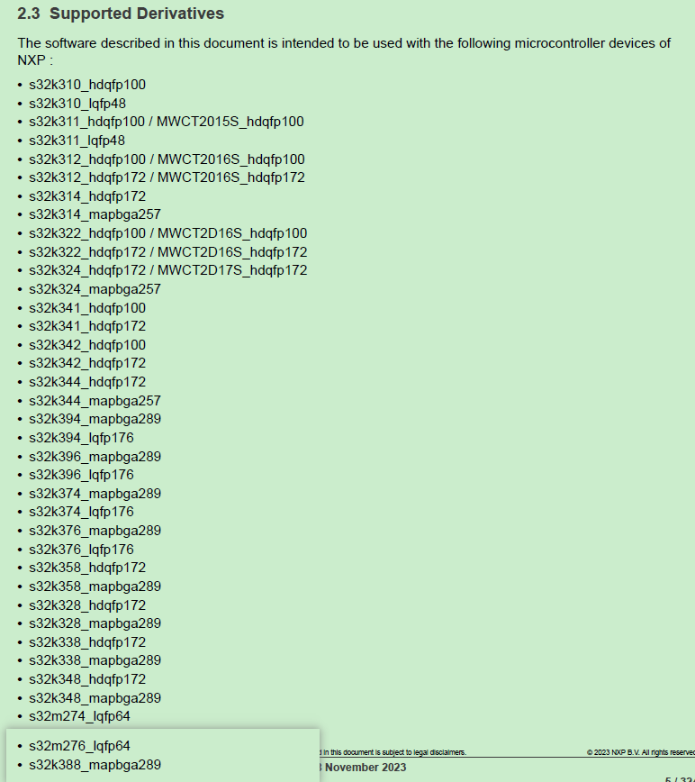

    From the release notes of NXP's RTD4.0.0, we can see that the supported chip models are very complete:
Fig 1
From this point, we can know that RTD4.0.0 can cover all S32K3 series chips. But if you want a ready-made demo, such as MCAL demo, you can see it under the ready-made demo path, for example:
C:\NXP\SW32K3_S32M27x_RTD_R21-11_4.0.0\eclipse\plugins\Dio_TS_T40D34M40I0R0\examples\EBT
Just S32K344,S32K358,S32K388,S32K396,S32M276。

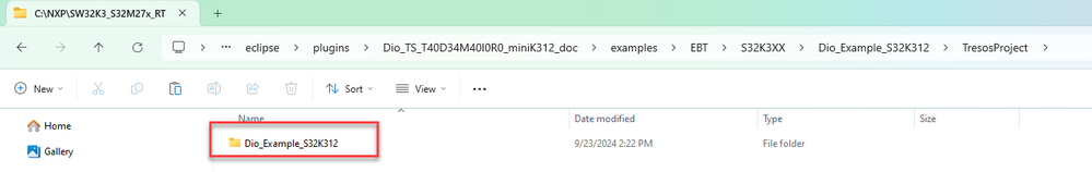

   Open path:
C:\NXP\SW32K3_S32M27x_RTD_R21-11_4.0.0\eclipse\plugins\Dio_TS_T40D34M40I0R0_miniK312_doc\examples\EBT\S32K3XX\Dio_Example_S32K312\TresosProject
 Modify the EB project Dio_Example_S32K344 to Dio_Example_S32K312
Fig 4

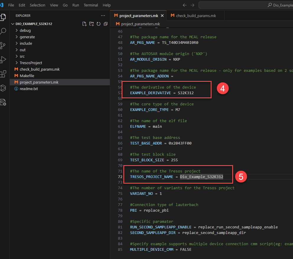

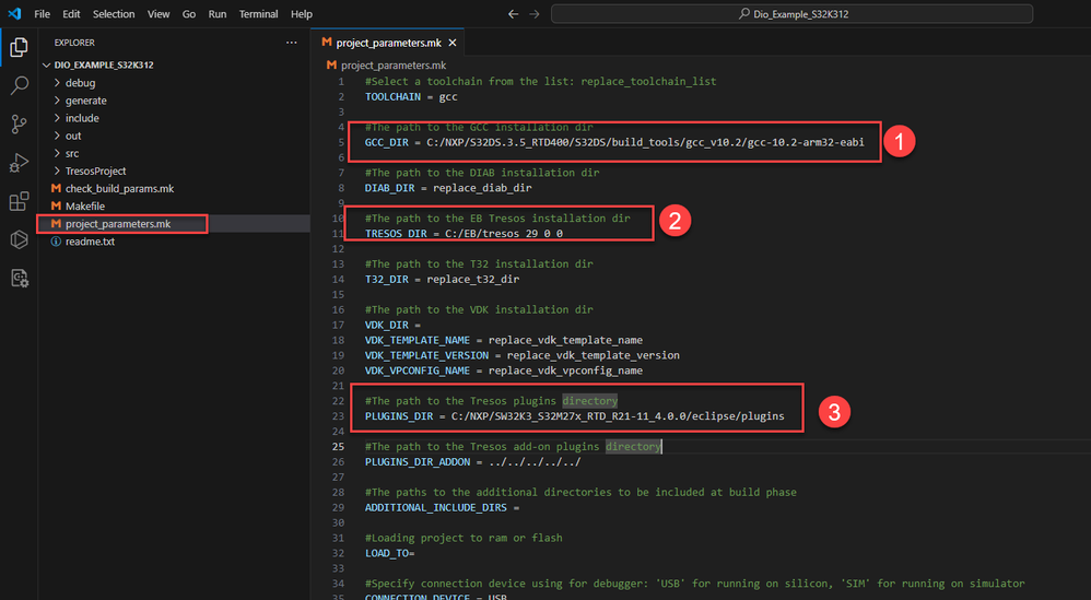

Enter the newly created Dio_Example_S32K312, open the path with VScode, and save the VScode workspace to this path.
Modify project_parameters.mk:
GCC_DIR = C:/NXP/S32DS.3.5_RTD400/S32DS/build_tools/gcc_v10.2/gcc-10.2-arm32-eabi
TRESOS_DIR = C:/EB/tresos_29_0_0
PLUGINS_DIR = C:/NXP/SW32K3_S32M27x_RTD_R21-11_4.0.0/eclipse/plugins
EXAMPLE_DERIVATIVE = S32K312
TRESO_PROJECT_NAME = Dio_Example_S32K312
Fig 5
Fig 6

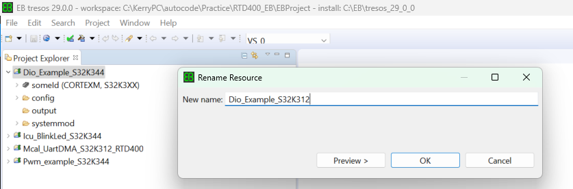

Select the project Dio_Example_S32K344, right-click the mouse, and rename it to: Dio_Example_S32K312
Fig 7

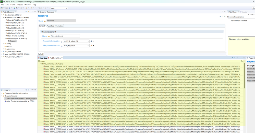

Open the Resource module, General->ResourceSubderivative select the target chip partbumber, here select: s32k312_hdqfp172
Fig 8

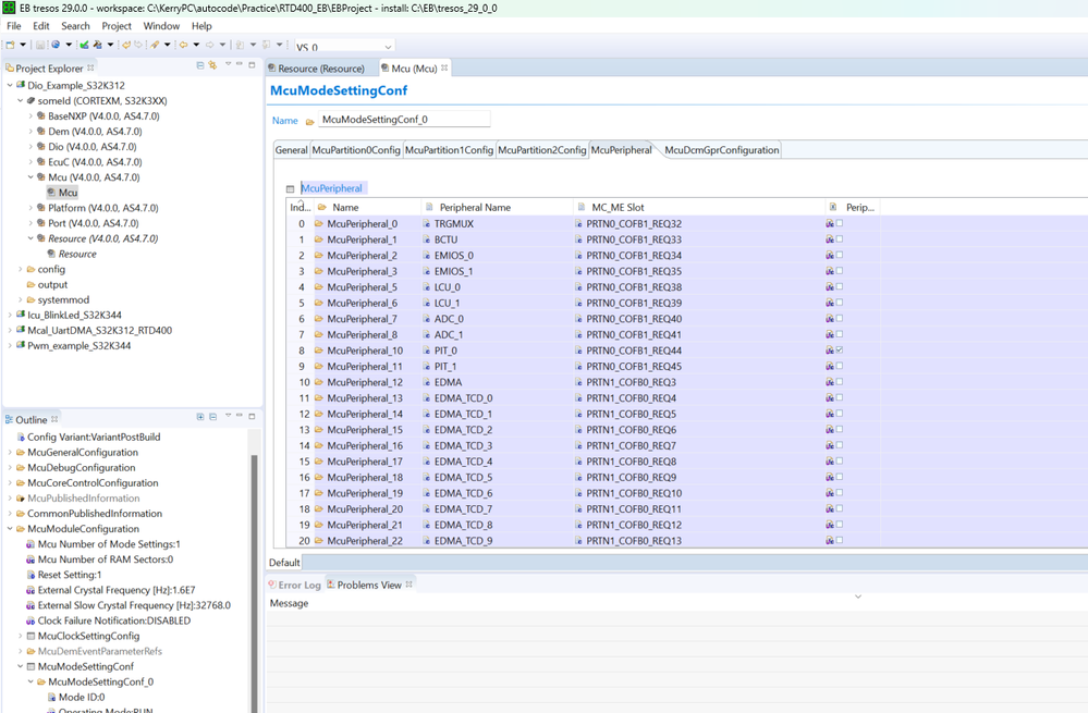

After saving, you will find many errors reported as follows:
Fig 9
There is no need to worry too much here, because if you analyze it carefully, you will find that it is actually because there are many modules on K344 that K312 does not have. So enter the error prompt location and delete the missing K312 module.
Mcu->McuModeSettingConf->McuPeripheral
If you click in, you can find that if the K312 does not have a module, there is a red cross in front of the peripheral Name.
Fig 10
The direct method is to delete all the error items, a total of 41.

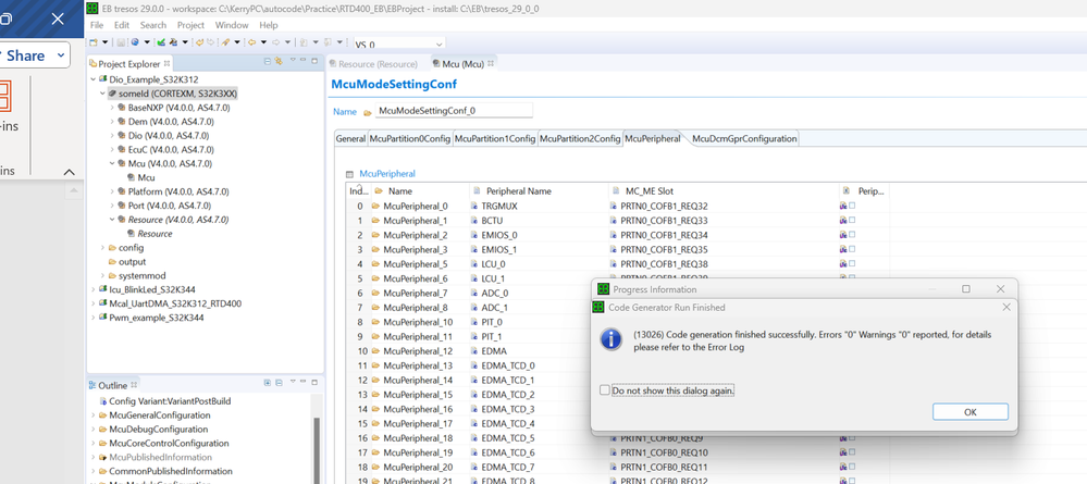

Select someId in the project, right-click, and click Generate Code. You can see that the project can be generated without any errors.
Fig12

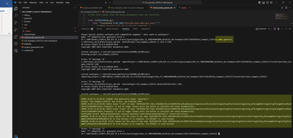

Don't take it lightly here. Although the code can be generated without error, there is still a place that needs to be modified.
Here, we can firstly close the EB tresos tool, then open terminal->new terminal in VScode and enter:
Fig13

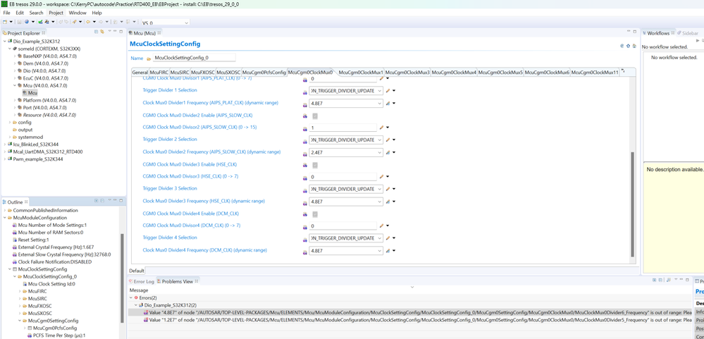

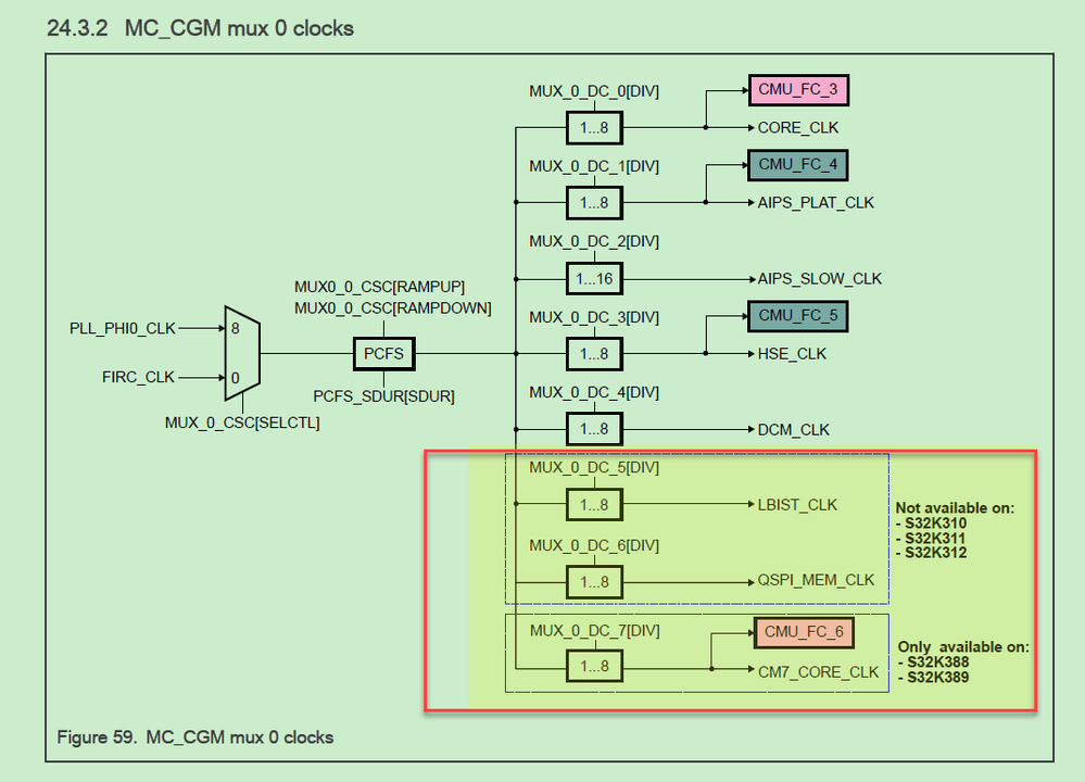

We can see the error content is : mcucgm0_clockMux0/McuClockMux0Divider5, McuClockMux0Divider6, McuClkMux0Div5_En, McuClkMux0Div6_En.
Open S32KRM here, and you can see that K312 actually does not have MUX_0_5,6.
Fig 14
At this time, when I opened the EB tresos software again, there was indeed such an error on the interface, and there was no divider 5,6 option in mcucgmClockMux0.
Fig 15
Don't worry at this time, there is a way to fix this problem.

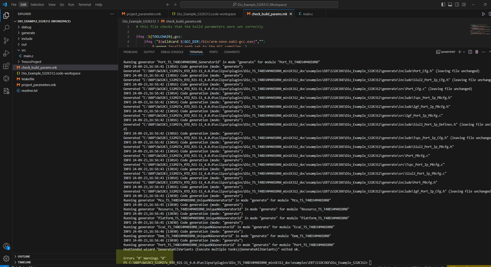

Close the EB software and enter make generate again in the terminal of the Vscode project
You can see that there are no problems at this time:
Fig 16

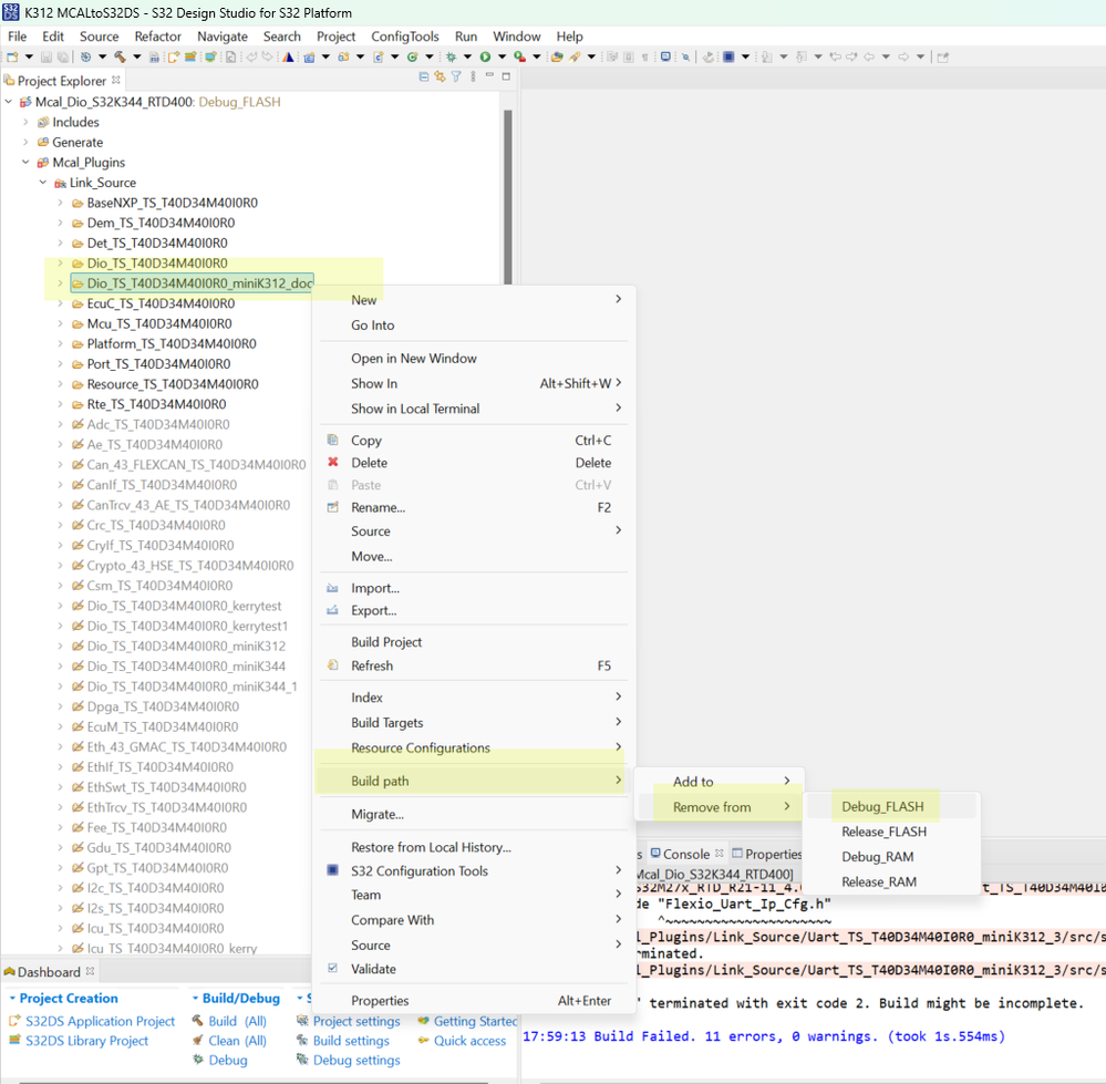

4.1 S32DS Project Configuration
    Because the folder was copied under the original RTD folder, there is a newly created folder in the S32DS project Mcal_Plugins->Link_Source. This folder needs to be excluded from compilation:
Select Dio_TS_T40D34M40I0R0_minik312_doc, right-click Build path->remove from->Debug_FLASH.
Fig 18

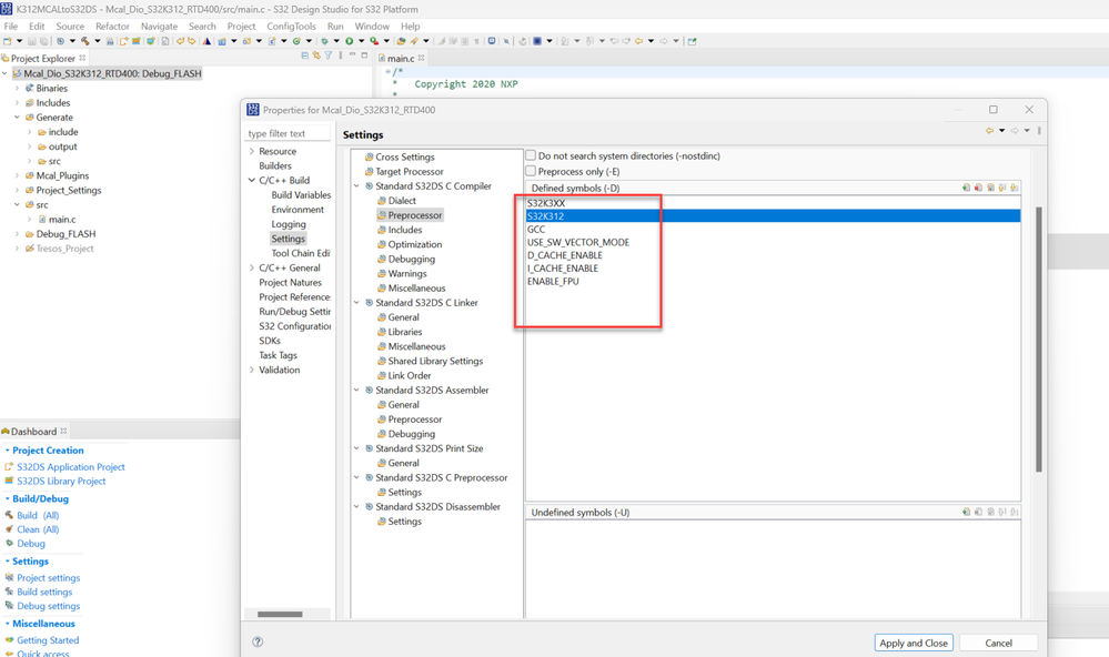

Modify the following project configuration, project->properties:
(1)preprocessor
S32K344->S32K312
Fig 19

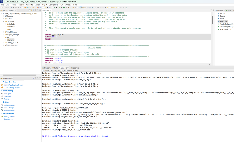

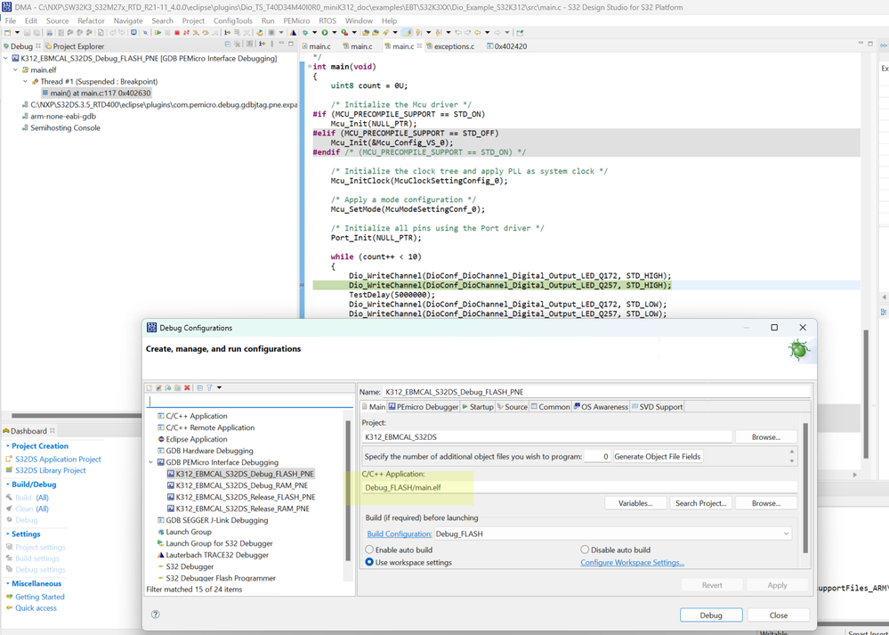

4.3 MCAL S32DS project testing
clean project:project->clean project,  then build the project
Fig 20

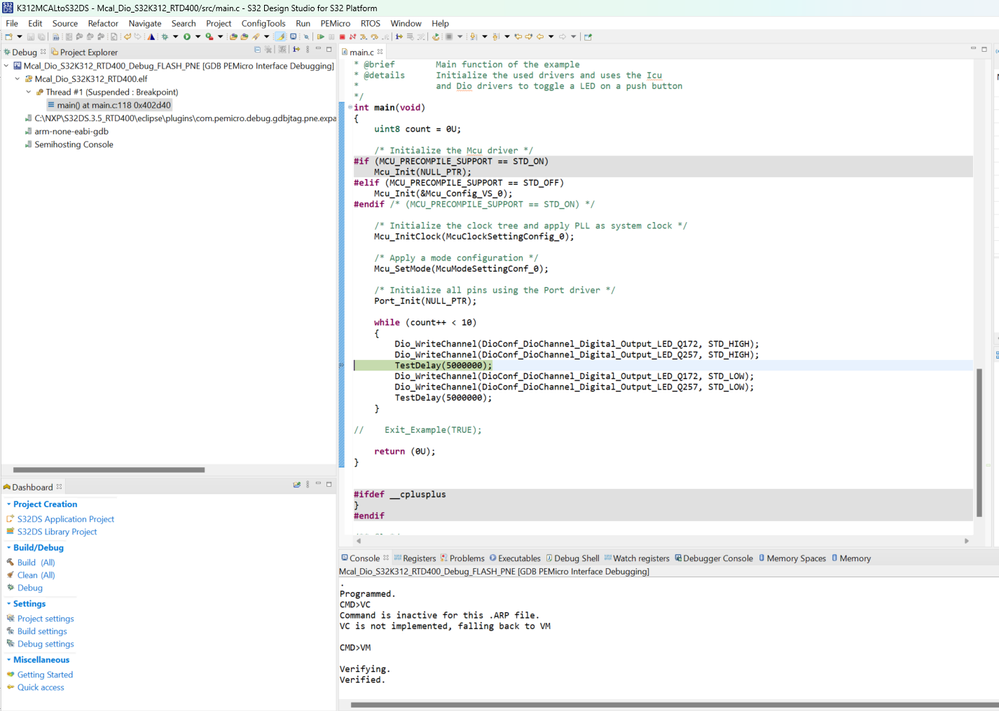

You can see that it can be compiled successfully, then RUN->debug configuration selects the downloaded code xxx_Debug_FLASH_PNE. Note that you need to change the Device from S32K344 to S32K312
Fig 21
After successful configuration, click debug, download the code and simulate. The results are as follows:
Fig 22
As you can see, we can successfully enter debug, and the light on the board is actually blinking, which means that the RTD MCAL project demo can be successfully ported to S32K312 S32DS.
