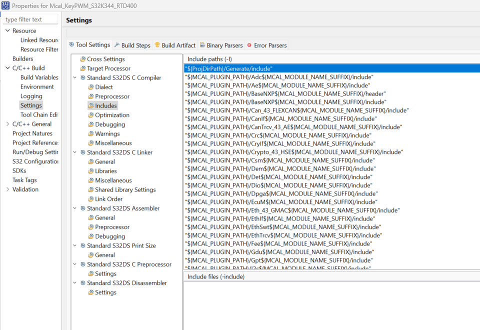

  1. Includes
Fig 2
"${ProjDirPath}/Generate/include"
"${MCAL_PLUGIN_PATH}/Adc${MCAL_MODULE_NAME_SUFFIX}/include"
"${MCAL_PLUGIN_PATH}/Ae${MCAL_MODULE_NAME_SUFFIX}/include"
"${MCAL_PLUGIN_PATH}/BaseNXP${MCAL_MODULE_NAME_SUFFIX}/header"
"${MCAL_PLUGIN_PATH}/BaseNXP${MCAL_MODULE_NAME_SUFFIX}/include"
"${MCAL_PLUGIN_PATH}/Can_43_FLEXCAN${MCAL_MODULE_NAME_SUFFIX}/include"
"${MCAL_PLUGIN_PATH}/CanIf${MCAL_MODULE_NAME_SUFFIX}/include"
"${MCAL_PLUGIN_PATH}/CanTrcv_43_AE${MCAL_MODULE_NAME_SUFFIX}/include"
"${MCAL_PLUGIN_PATH}/Crc${MCAL_MODULE_NAME_SUFFIX}/include"
"${MCAL_PLUGIN_PATH}/CryIf${MCAL_MODULE_NAME_SUFFIX}/include"
"${MCAL_PLUGIN_PATH}/Crypto_43_HSE${MCAL_MODULE_NAME_SUFFIX}/include"
"${MCAL_PLUGIN_PATH}/Csm${MCAL_MODULE_NAME_SUFFIX}/include"
"${MCAL_PLUGIN_PATH}/Dem${MCAL_MODULE_NAME_SUFFIX}/include"
"${MCAL_PLUGIN_PATH}/Det${MCAL_MODULE_NAME_SUFFIX}/include"
"${MCAL_PLUGIN_PATH}/Dio${MCAL_MODULE_NAME_SUFFIX}/include"
"${MCAL_PLUGIN_PATH}/Dpga${MCAL_MODULE_NAME_SUFFIX}/include"
"${MCAL_PLUGIN_PATH}/EcuM${MCAL_MODULE_NAME_SUFFIX}/include"
"${MCAL_PLUGIN_PATH}/Eth_43_GMAC${MCAL_MODULE_NAME_SUFFIX}/include"
"${MCAL_PLUGIN_PATH}/EthIf${MCAL_MODULE_NAME_SUFFIX}/include"
"${MCAL_PLUGIN_PATH}/EthSwt${MCAL_MODULE_NAME_SUFFIX}/include"
"${MCAL_PLUGIN_PATH}/EthTrcv${MCAL_MODULE_NAME_SUFFIX}/include"
"${MCAL_PLUGIN_PATH}/Fee${MCAL_MODULE_NAME_SUFFIX}/include"
"${MCAL_PLUGIN_PATH}/Gdu${MCAL_MODULE_NAME_SUFFIX}/include"
"${MCAL_PLUGIN_PATH}/Gpt${MCAL_MODULE_NAME_SUFFIX}/include"
"${MCAL_PLUGIN_PATH}/I2c${MCAL_MODULE_NAME_SUFFIX}/include"
"${MCAL_PLUGIN_PATH}/I2s${MCAL_MODULE_NAME_SUFFIX}/include"
"${MCAL_PLUGIN_PATH}/Icu${MCAL_MODULE_NAME_SUFFIX}/include"
"${MCAL_PLUGIN_PATH}/Lin_43_LPUART_FLEXIO${MCAL_MODULE_NAME_SUFFIX}/include"
"${MCAL_PLUGIN_PATH}/LinIf${MCAL_MODULE_NAME_SUFFIX}/include"
"${MCAL_PLUGIN_PATH}/LinTrcv_43_AE${MCAL_MODULE_NAME_SUFFIX}/include"
"${MCAL_PLUGIN_PATH}/Mcl${MCAL_MODULE_NAME_SUFFIX}/include"
"${MCAL_PLUGIN_PATH}/Mcu${MCAL_MODULE_NAME_SUFFIX}/include"
"${MCAL_PLUGIN_PATH}/Mem_43_EEP${MCAL_MODULE_NAME_SUFFIX}/include"
"${MCAL_PLUGIN_PATH}/Mem_43_EXFLS${MCAL_MODULE_NAME_SUFFIX}/include"
"${MCAL_PLUGIN_PATH}/Mem_43_INFLS${MCAL_MODULE_NAME_SUFFIX}/include"
"${MCAL_PLUGIN_PATH}/MemAcc${MCAL_MODULE_NAME_SUFFIX}/include"
"${MCAL_PLUGIN_PATH}/MemIf${MCAL_MODULE_NAME_SUFFIX}/include"
"${MCAL_PLUGIN_PATH}/Ocotp${MCAL_MODULE_NAME_SUFFIX}/include"
"${MCAL_PLUGIN_PATH}/Ocu${MCAL_MODULE_NAME_SUFFIX}/include"
"${MCAL_PLUGIN_PATH}/Os${MCAL_MODULE_NAME_SUFFIX}/include"
"${MCAL_PLUGIN_PATH}/Platform${MCAL_MODULE_NAME_SUFFIX}/include"
"${MCAL_PLUGIN_PATH}/Platform${MCAL_MODULE_NAME_SUFFIX}/startup/include"
"${MCAL_PLUGIN_PATH}/Port${MCAL_MODULE_NAME_SUFFIX}/include"
"${MCAL_PLUGIN_PATH}/Pwm${MCAL_MODULE_NAME_SUFFIX}/include"
"${MCAL_PLUGIN_PATH}/Rm${MCAL_MODULE_NAME_SUFFIX}/include"
"${MCAL_PLUGIN_PATH}/Rte${MCAL_MODULE_NAME_SUFFIX}/include"
"${MCAL_PLUGIN_PATH}/Sent${MCAL_MODULE_NAME_SUFFIX}/include"
"${MCAL_PLUGIN_PATH}/Spi${MCAL_MODULE_NAME_SUFFIX}/include"
"${MCAL_PLUGIN_PATH}/Uart${MCAL_MODULE_NAME_SUFFIX}/include"
"${MCAL_PLUGIN_PATH}/Wdg${MCAL_MODULE_NAME_SUFFIX}/include"
"${MCAL_PLUGIN_PATH}/WdgIf${MCAL_MODULE_NAME_SUFFIX}/include"
"${MCAL_PLUGIN_PATH}/Zipwire${MCAL_MODULE_NAME_SUFFIX}/include"

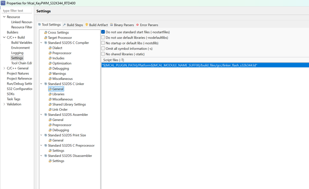

  1. Linker
Fig  4
"${MCAL_PLUGIN_PATH}/Platform${MCAL_MODULE_NAME_SUFFIX}/build_files/gcc/linker_flash_s32k344.ld"

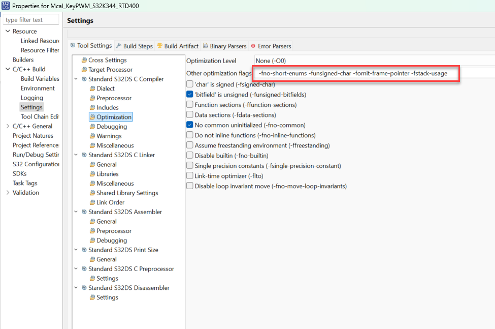

  1. optimization
Fig 5
-fno-short-enums -funsigned-char -fomit-frame-pointer -fstack-usage
