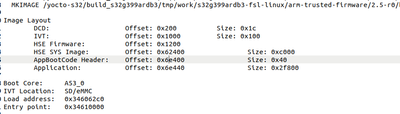

I want to update the image layout as per my blob. Is this possible to do ? The above is the snip from the log do compile file which is generated while bitbake. Is it possible to update the offset how to change the offset of HSE ? Which file need to be updated ?

I am integrating hse on a53 and m7 core. I am checking if it is possible to update the image layout in the log do compile file as the offset in image layout for hse firmware is mentioned to be 0x1200 and in my blob it is 0x1000.

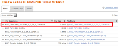

Also, I recommend having the HSE working first on the M7 and after on the A53 separately. This to know each process works and after that do the integration to work from both.
For that download the HSE Demo APP to learn how to do the configuration at the M7 following the Readme.
Remember to download the HSE Version that is compatible with your BSP version.

I am currently working on the A53 core with Yocto BSP 42, and during the compilation process, I observed the following image layout details in the log.do_compile file :
Image Layout
  DCD:      Offset: 0x200    Size: 0x1c
  IVT:      Offset: 0x1000    Size: 0x100
  HSE Firmware:    Offset: 0x1200
  HSE SYS Image:    Offset: 0x62400    Size: 0xc000
  AppBootCode Header:  Offset: 0x6e400    Size: 0x40
  Application:    Offset: 0x6e440    Size: 0x2f800
Boot Core:  A53_0
IVT Location:  SD/eMMC
Load address:  0x346062c0
Entry point:  0x34610000
Could you kindly help me understand the following:
  1. Which file or configuration in the Yocto build system is responsible for generating or computing this image layout?
  2. How can I locate and modify the source file(s) that define these offsets, sizes, and other parameters?
Your guidance on this matter will be greatly appreciated.
Thank you in advance for your support!

carlos_o
Hi @ashwini2024,
That configuration is not supported by NXP, please refer to the Yocto Project with further help with this topic.
