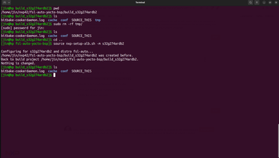

Issue with Rebuilding DTB After Removing sstate-cache
We were instructed to remove both the sstate-cache and tmp directories to rebuild the DTB. However, we noticed that the tmp directory contains the dtsi file, which we modified to build the updated dtb file. Therefore, we only removed the sstate-cache and proceeded with the rebuild.
Despite this, the DTB build date remains unchanged, suggesting that the build is still relying on cached data instead of regenerating from the modified dtsi file.
How can we ensure the DTB is rebuilt using the updated dtsi file without deleting the entire tmp directory?

carlos_o
Hi @KavithaSasikumar,
Did you clone the repository at the tmp directory?
It seems like that at the screenshots you share.
Try to clone it in another directory, clear the tmp folder and rebuild with your device tree changes.

carlos_o
Delete the tmp directory and after that run
$ source nxp-setup-alb.sh -m s32g274ardb2
After that put your changes at s32cc.dtsi
Once you have your modifications you can run
$ bitbake fsl-image-auto
every time you run "source nxp-setup-alb.sh -m s32g274ardb2" it overwrites the s32cc.dtsi

KavithaSasikumar
We followed the above process but the shortcomings we are facing are:
1. If we delete the tmp file...we cannot edit the s32cc.dtsi file since this .dtsi file is located in tmp.
2. Also, after adding the command suggested in the community forum         ".$ source nxp-setup-alb.sh -m s32g274ardb2" also,  there is no change.
So, kindly guide us further since its really critical for us to complete this STR process, by providing us with necessary reference or steps to follow.
