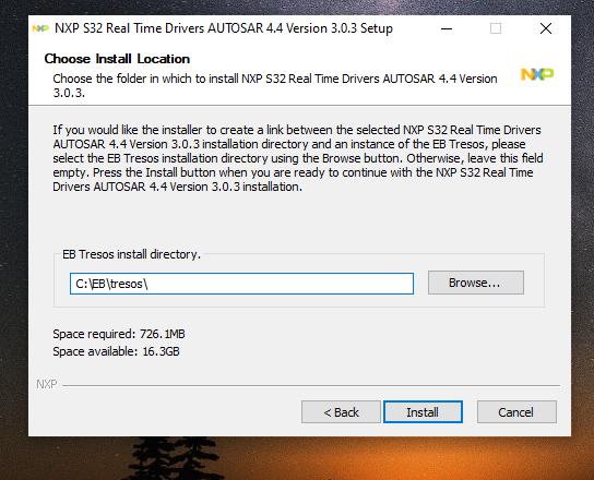

The GoldVIP-gateway project is loading missing components on EB
3 返答(返信)
2,186件の閲覧回数
nxf92355
Hi gao qifa ,
Hope you are doing well
You can link module with EB tresos during installation time of module.
As shown below you will be ask to Choose install location for EB tresos
Browse the EB path like C:\EB\tresos
installation will automatically link to EB tresos
Or another way is copy.
For missing modules you can copy module plugins to your EB Tresos Plugins Directory (C:\EB\tresos\plugins)
For GoldVIP 1.9.0 plugins
  • Extract GoldVIP-S32G2-1.9.0-binaries.zip
  • Go to \GoldVIP for S32G2 1.9.0\configuration\s32g274ardb2\can-gw\eclipse\plugins
  • Extract plugins.zip
  • Copy and paste it into C:\EB\tresos\plugins
 RTD 4.0.1 Plugins:
  • Run SW32G_RTD_4.4_4.0.1_D2302.exe
  • Find the folder under C:\NXP\SW32G_RTD_4.4_4.0.1_D2302
  • Copy module plugins C:\NXP\SW32G_RTD_4.4_<version>\eclipse\plugins to C:\EB\tresos\plugins
 Platform Software Integration 2023_06 Plugins
  • Run Platform_Software_Integration_S32G2_2023_06.exe
  • Perform the same procedure as above
