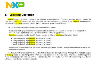

Hi All:
How to enable the lockstep mode of the S32G during the boot stage? Are there any detailed references?
I only saw the description of the lockstep register in the manual, which needs to be configured in the M7 core. Can it be configured through DCB?
Thinks!

Joey_z
hi,liuchi
Thank you for your reply.
You can refer to the BSP User Manual and find more lockstep operation.
Hope it can help you.
