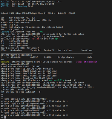

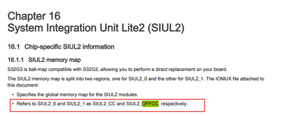

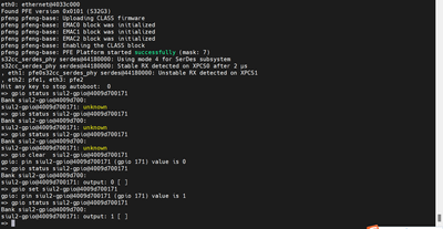

GG0712
Hi Joey_z,
I toggle 171/173 failed when I try to using siul2 and pins config by default and using siul2 by BSP43 but pins config by default
In S32G3_IOMUX 2 file, the gpio 28 module is SIUL_CC and the gpio 171/173  module is SIUL_OFFCC , are thereany differences between these modules?
$ gpio status -a
siul2-gpio@4009d70028: unknown
siul2-gpio@4009d700171: unknown
siul2-gpio@4009d700172: unknown
siul2-gpio@4009d700173: unknown
=> gpio set siul2-gpio@4009d700173
gpio: pin siul2-gpio@4009d700173 (gpio 173) value is 1
Warning: value of pin is still 0
=> gpio toggle siul2-gpio@4009d700173
=> gpio set siul2-gpio@4009d700171
gpio: pin siul2-gpio@4009d700171 (gpio 171) value is 1
=> gpio toggle siul2-gpio@4009d700171
=> gpio toggle siul2-gpio@4009d70028
gpio: pin siul2-gpio@4009d70028 (gpio 28) value is 1
=> gpio clear siul2-gpio@4009d70028
gpio: pin siul2-gpio@4009d70028 (gpio 28) value is 0
6,105 Views
Joey_z
hi,GG0712
Thank you for your reply.
It is normally to use the gpio 171/173 for BSP43 on our development board, you can try to cancel the 10k pulldown resistance. The status of unknown should be not to set the gpio.
You can check the status, if you have been set the gpio as shown the following picture.
in addition, Refers to SIUL2_0 and SIUL2_1 as SIUL2_CC and SIUL2_OFFCC in S32G3_IOMUX.
Hope it can help you.
Joey

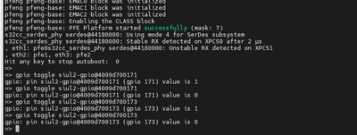

GG0712
Hi Joey_z,
Currently we using BSP35.
I can toggle gpio 171/173 with BSP43 without any modify.
Do you have change list from BSP35 to BSP43?
We can compare and move commit to BSP35

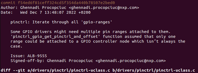

GG0712
Hi Joey_z,
We found the solution in BSP36.
The commit f54ed6f81ceff324cd5f354da440b78507e2bed0 show that why we can not toggle SIUL2_1 related GPIO.
I can toggle 171/173 GPIO after I merge this commit and without any modify in ATF and u-boot.
Thanks for your help.
