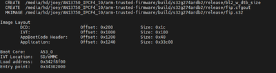

Joey_z
hi,Allen_Cheng
Did you change the ATF Load address and Entry point in the Bootloader? As shown in the following figure, the corresponding address is different for different versions of BSP.
Also, you need to check that no SRAM image loading and running addresses of M7 and fip are conflicting
Joey

Allen_Cheng
Hi Joey,
The ATF load address are the same in bsp41/bsp42.
Entry point are 0x34700000.
Thanks.

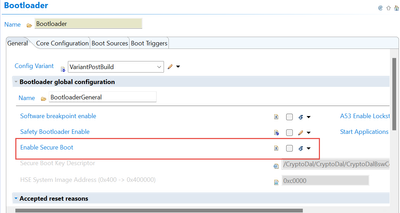

Joey_z
hi,Allen_Cheng
Sorry for the late reply.
You can try Disable Secure Boot, as shown in the image below.
In addition, if you are not using mmc patch, make sure you modify the s32_common.mk file.
Wish it can help you.
Joey
7,472 Views
Allen_Cheng
Hi Joey,
I try to disable secure boot in EB tresos and disable HSE in u-boot.
But it looks like the same result.
Thanks.
7,375 Views
