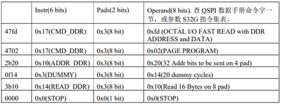

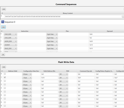

I created the file for the QSPI config based on info from the SoM provider, they use a similar config to boot Yocto based system, (by similar I mean they don't use the nxp IDE to program their system).
When I saw the resulting file, this was the same as the one in the reference I quote.
the note about "However, there are some registers I did not see mentioned in the guide but were modified":
In the NXP ide the setting as you saw them are:
As I mentioned it ia custom board, using a SoM, I don't have the option to instrument it to get the requested signals.
About the " For the following registers, can you provide more information as why you changed them? since I cannot access the memory documentation. " => The changes I did were based on the info from the SoM provider.
And they are the same as in the quoted ref.:
The QSPI config. are confirmed to work in a linux system.

I think there might be a confusion, I was asking why the change in the registers: MDIS, PPWB, TPADA1 and TPADA2, since I don't see those registers mentioned in the guide (1399906). I checked your binary in S32DS and saw the changes. To reduce the problem, please share the following information:
  • RCON word value
  • Are you using parallel RCON (dip switches) or serial RCON (EEPROM memory)?
  • I understand you obtained your board from a manufacturer, what is the brand and model of the board?
  • With your last message I understand that the register configuration and the LUT sequence you are using have been tested with Linux during runtime, is that correct?
  • Comparing one of the available configurations with yours I notices that de padded part is in 0xFF in yours and it is 0x00 in one of the provided by us, on the right is your configuration and on the left is one of the available after isntalling S32DS:
    • Did you changed this deliberately?
