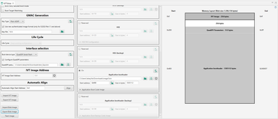

We're using Micron NOR Flash MT35XU512ABA1G12-0AUT on our board.
And we have problem boot from NOR flash. (The simple application is to toggle PE_01 to flash LED)
I have attached related file below:
1. QuadSPI parameter file: test_Qspi.bin
2. Bootloader+application combined bin: led_test_0606_blob2.bin
3. S32 Flash Tool Algorithm: fsdk_qSpi_mt35xu512.bin
Could you help check if there is any step missing?

hi,JalseyXie
Thank you for contacting us.
Did you can used the  fsdk_qSpi_mt35xu512.bi Algorithm normally in  S32 Flash Tool to program the NOR Flash?  Also, could you used the debugger for the simple application to toggle PE_01?

Joey_z
hi,JalseyXie
Sorry for the reply late.
Please check whether the following address is filled in correctly.
If you confirm that there is no problem with your burning method.
You can try using M or A core to check whether the content you burn to NOR FLASH is correct and see if there are any problems with your burning algorithm.
Hope it can help you.
