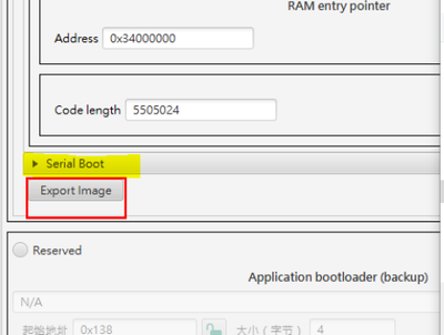

Please see the last page's error message of attach file. The attach picture (2022-02-10_151954.jpg) is the error message , too.
Please Kindly help me to go next step .

Your IVT tool fails because you are giving it a wrong file as the bootloader
image. Besides that, you are generating an S-rec file which is useless in your case.

It is very difficult to comment the materials you attach because you are using
a local language S32DS. Note that NXP Technical Support is an international
service with engineering teams located worldwide. It is always better to
use an international S32DS installation if you are planning to exchange any
materials with us.
One visible potential problem is that you set your binary entry point at the
start of the image. Usually it is not the case. See this document, slide 21
on how to find and fill the correct values. You may also need to modify
your linker file as to avoid overwriting the reserved SRAM areas. Slide 18
of the same document gives you an idea.
Another potential problem appears on slides 17 and 18 of your report. This does not
seem to match your boot device:
