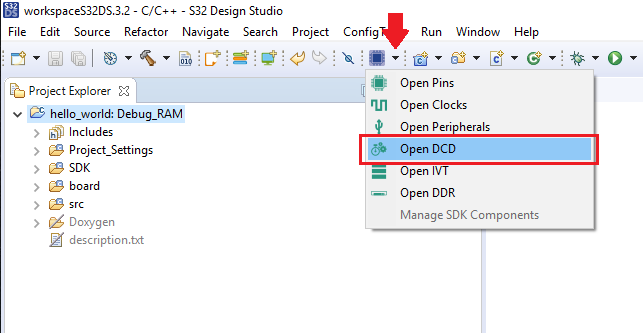

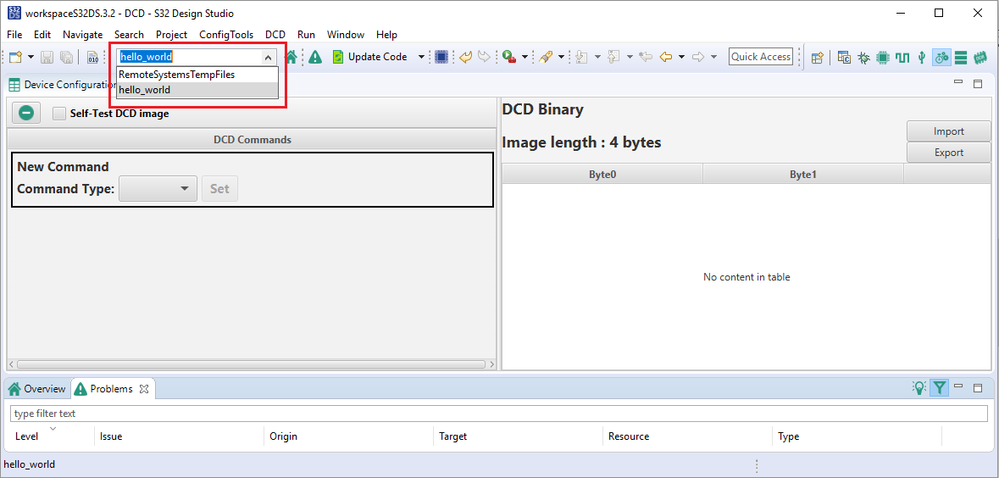

  1. With a project open in project explorer (C/C++ perspective), switch to DCD perspective. Click on the arrow next to the 'Open S32 Configuration' button and select 'Open DCD'.
  2. Check that correct project is selected

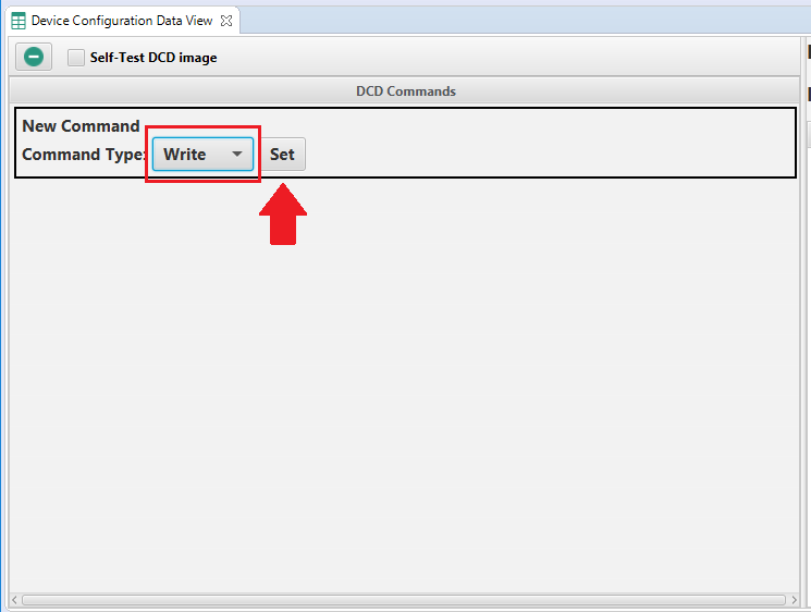

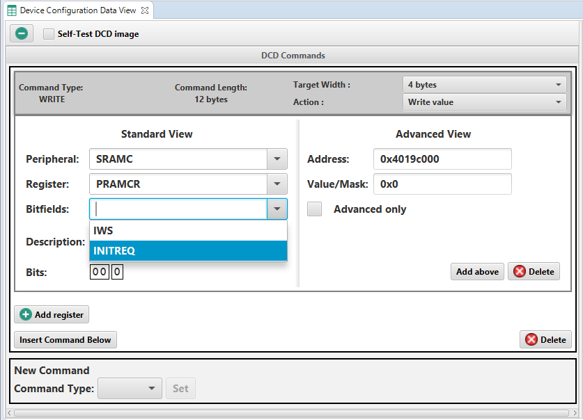

  3. In DCD Commands panel, select Command Type 'Write', then click 'Set'

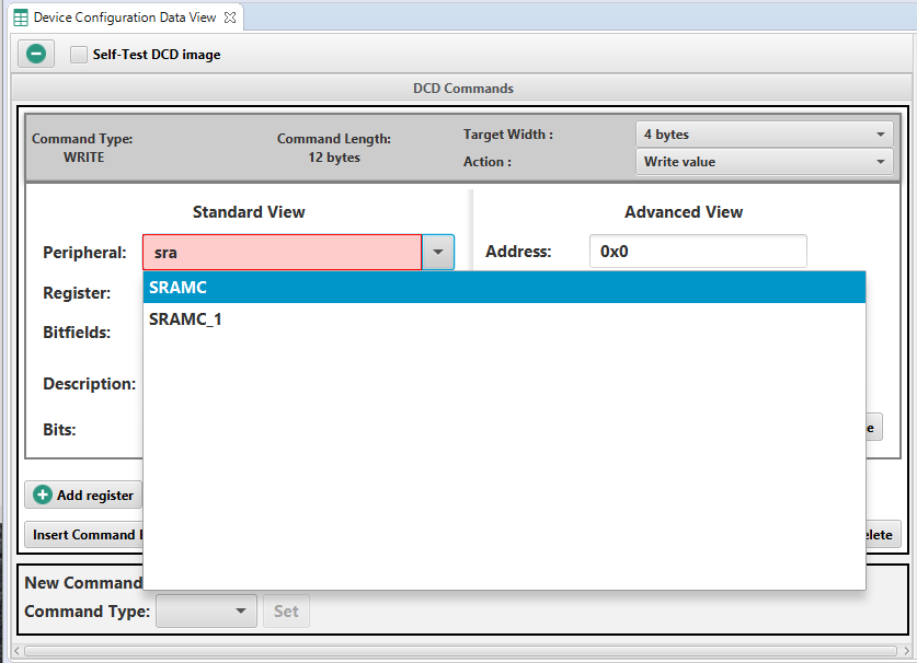

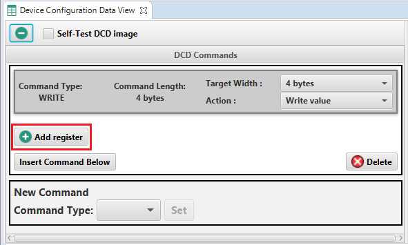

  4. Click 'Add Register', then set the following settings. Can start typing the names to filter the list for faster setting selection.
    1. For Peripheral setting, select 'SRAMC'. You can search for it by typing the name.

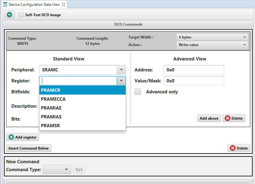

    2. Register setting, select 'PRAMCR'. The list is short, so it is not necessary to type the name.

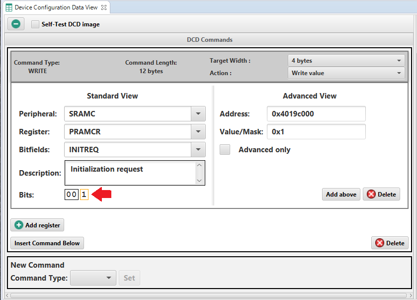

    3. In Bitfields, select 'INITREQ'
    4. Now click on the highlighted bit to set it.
  5. Again using 'New Command' box, repeat settings of steps 3 & 4, however, this time select Peripheral 'SRAMC_1'.

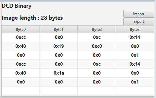

  6. If everything was done correctly, in the DCD Binary panel to the right, should appear as shown. If so, click 'Export'.

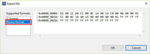

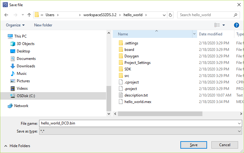

  7. The generated DCD file will be displayed. By default, C format is selected. Select Binary format and click OK.
  8. Select a location to save the file (such as the project folder in the workspace directory) and give it a meaningful name. Click Save.
  9. You are done! DCD image file is created in binary format and ready to be imported to IVT Tool.
