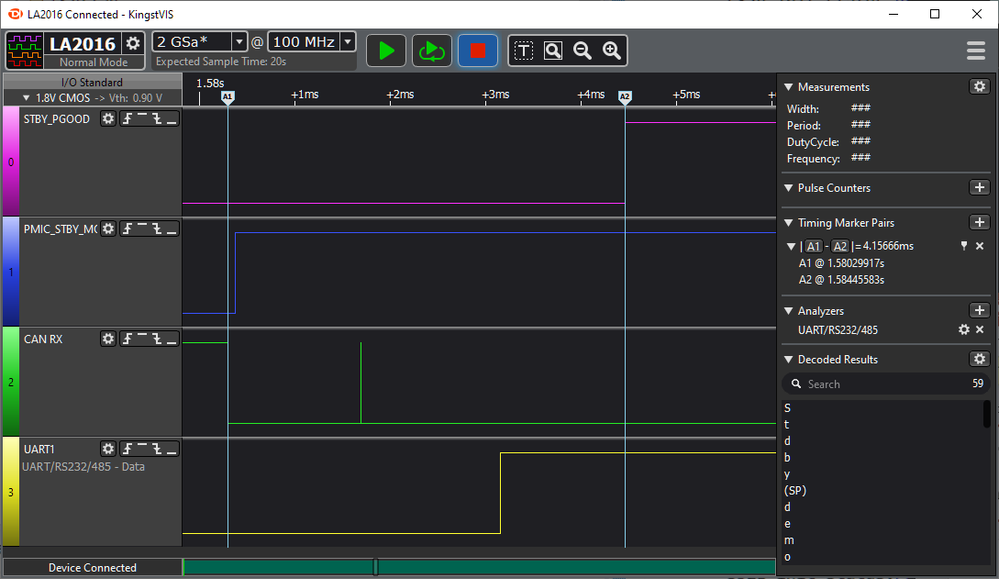

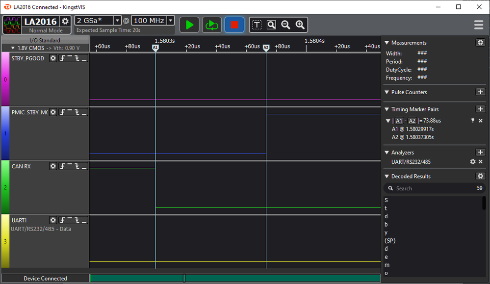

Adding timing measurements at wakeup done on a RDB2 board (you can read the duration in the |A1-A2| Timings Marker Pairs):
  • Pink: PMIC_STBY_MODE_B
  • Blue: STBY_GOOD (PMIC_VDD_OK)
  • Green: CAN_RX (wakeup source, you'll see bounce as I touch manually the ground)
  • Yellow: UART1 (can be seen as startup).

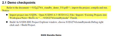

where can I find the S32G M7 core Standby demo which you a referencing here and which I shall import
Import project into S32DS:Open S32DS3.4.3+RTD3.0.2, File->Import->Existing Projects into
Workspace/Next->Brows to “….\S32G274Astandbymode” /Finish.
thanks
Jochen
do your means you need the S32DS hard coding project? and if you use the mcal, suggest you use the mcal demo in the attachment.
and if you need the S32DS one, pls contact your NXP windows FAE to get it.
Not sure what you mean with hard coding project
I like to have the Design Studio Project so I can modified and build it.
To my understanding this is described under chapter 2.1 but as said I can't find the standby demo project nor the ...UG.pdf
PS: I'm FAE but not sure what a window FAE is...
