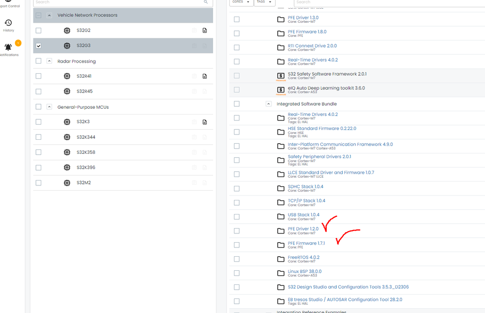

We are developing S32G-VNP-RDB3 (s32g399a) based on RTOS. I know we need to use PFE to use more than one Ethernet port, but PFE requires a separate driver to be applied, and I don't know how to do that.
To rephrase my question, it is as follows.
1. How to use PFE function in S32G-VNP-RDB3(s32g399a)?
2. is there any demo file for PFE's PTP and TIME Aware Shaper features?
If anyone knows how to use it, please help me.... Please help...

On regards of PFE usage under the M7 core (which we assume is the one being used with RTOS), there is a PFE Driver for M7 MCAL, which should be available under the Automotive Software Package Manager inside the S32G3 product page (link: S32G3 Safe and Secure Vehicle Network Processor | NXP Semiconductors). The specific version needs to be paired with an specific version of RTD, which should be also available under the Automotive Software Package Manager.
As for the specifics of being implemented with RTOS, we understand that the available examples do not use RTOS. As for the specific features, we understand that they are not implemented under the available examples. We do apologize.

Youngsoo_do
I am very grateful for your response.
I went to the site you told me about and downloaded the Dirver and Firmware for PFE, and I had additional questions in the process.
Q1. Is it mandatory to use Tresos to use PFE FW?
  Q1.1. I installed the PFE FW plugin from Tresos, but when I open it in Tresos, I get a license error like in the attached picture.
Q2. Do you know any documentation explaining how to use PFE FW in S32 Design Studio?
Q3. Is PFE FW used in conjunction with PFE MCAL Driver?

Youngsoo_do
Hi ! Thank you very much for your response.
about Q1
When I got the tresos from that page (link: S32G3 Safe and Secure Vehicle Network Processor | NXP Semiconductors), I could not get any confirmation regarding the license. Instead, I downloaded version 29 from the place where you can download different versions, checked the activation code, activated it, and am using it.
About Q2 and Q3
I'm having trouble using and developing it due to the lack of documentation. I will try to check the related release notes.
Thank you for your help. For additional questions, I will create a new session to ask.
