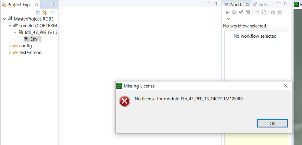

Q1. Is it mandatory to use Tresos to use PFE FW?
  Q1.1. I installed the PFE FW plugin from Tresos, but when I open it in Tresos, I get a license error like in the attached picture.

Below will be some comments on regards of your questions:
[DA]: We understand that the PFE MCAL driver is only to be used with EB Tresos. As for the license error, did you activate EB Tresos itself?

Youngsoo_do
Hi ! Thank you very much for your response.
about Q1
When I got the tresos from that page (link: S32G3 Safe and Secure Vehicle Network Processor | NXP Semiconductors), I could not get any confirmation regarding the license. Instead, I downloaded version 29 from the place where you can download different versions, checked the activation code, activated it, and am using it.
