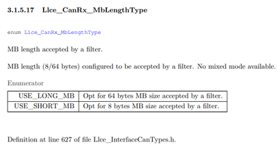

When I send a CAN standard frame (8bytes), via my CAN log tool, to the LLCE, it handles it as if it is a long frame (greater than 8Bytes).So When I get the Rx descriptor table index, I found it lower than LLCE_CAN_CONFIG_MAXRXMB (1732) which corresponds to the long frames.
I should have gotten an index greater than LLCE_CAN_CONFIG_MAXRXMB because I send to LLCE only short frames.

Are you using any of the NXP available examples? Can you share with us the configuration for the CanHardwareObject you are using and shows the behavior? How did you configure the CanObject Payload Lenght?
For the information, there is only 2 types of messages and it is defined by the following structure:
Seems to be a misconfiguration of the filter at this moment.

Hi @Daniel-Aguirre ,
Indeed you are right. I solved the problem.
The issue was due to the fact that I've not set Llce_CanRx_MbLengthType to the correct value.
