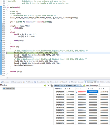

Hi Sir,
Could you provide an example of allocating & releasing memory on S32DS?
1,141件の閲覧回数
Daniel-Aguirre
Are you referring to the usage of malloc() and free() functions?
If so, we do not see any specific implementation for it. You should be able to use it just by adding the required library, as shown below:
