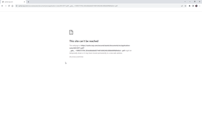

SSyb
Hi all, It seems under the link found in above solution, AN12971 can not be downloaded anymore (see error screenshot. I would like to read that one as suggested by one of the NXP FAEs).
Any hint where I can get this application note ?
best regards, Stefan
