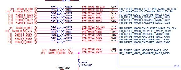

Hello Community,
I would like to enable pfe2 on my custom board.
Main soc is S32G274a and I am developing with bsp version 41.
KSZ9031 phy is connected pfe2 directly as same as S32G2-VNP-RDB2(Rev C2) but I cannot find any configuration enabling pfe2.
Could you let me know how to do ?
Harry

5,466 次查看
chenyin_h
Hi, @harry_choi
Thanks for your reply.
I will check it further later, may I know if you have also tested the reverse side, ping from host to the board, could the data received by the phy?
Chenyin
5,432 次查看
harry_choi
Hello Chenyin,
Of course, I doubled checked reverse side but there was no ping response from the board.
Is not the interrupt pin on KSZ9031 to SoC required?
And also is not the 3.3V RGMII VDD related with this problem?
Harry

harry_choi
Hi Chenyin,
I believe there is a problem on RGMII interface between SoC and Phy chipset because there is no problem on link detection but there is no data on RGMII enable and data line.
Here is our HW design.
It is different on RGMII VDD compared with your reference board.
The reference board uses 1.8V by default but we designed to use 3.3V.
But I cannot find the problem now.
Could you advise ?
Harry
