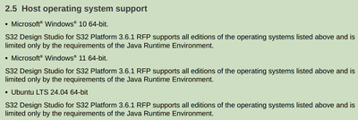

From the release notes of S32DS3.6.1, the following OS are supported for S32DS3.6.1, I suggest trying installing it on the OS supported for another trial.
Chenyin

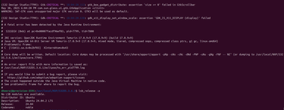

pcentauri92
Hi @chenyin_h ,
I have updated my OS to the latest version which is compatible with S32 Design studio v3.6.1 and the issue still exists as you can see below.

pcentauri92
Hi @daniel_ll ,
My distribution comes with X11 by default and I have been able to use the design studio by setting the GDK_BACKEND environment variable.
export GDK_BACKEND=x11
However, fthe issu still exists without the use of that variable.  My distribution version is as shown below
PRETTY_NAME="Ubuntu 24.04.2 LTS"
NAME="Ubuntu"
VERSION_ID="24.04"
VERSION="24.04.2 LTS (Noble Numbat)"
VERSION_CODENAME=noble
ID=ubuntu
Has a fix been released for this in the newer version of ubuntu (25.10) ?
