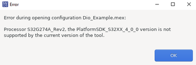

After removing the suggested package RTD S32 The following is list of S32 packages installed:
And opening the configuration tool creates the following message:
and configuration tool no starts.

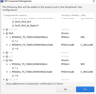

"The known problem with missed package dio.driver. I solved as in the past by adding it."
We understand that did the same steps you did before of adding the package manually, is this correct?
If so, this should not be done. When you click the "Update Code" button, the missing packages will be added automatically, if no errors are detected.

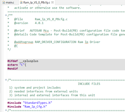

From our side we are not seeing any problems as the ones you are seeing, since we see the files have code under them:
DanielAguirre_0-1710253622955.pngDanielAguirre_0-1710253622955.pngDanielAguirre_1-1710253638606.pngDanielAguirre_1-1710253638606.pngDanielAguirre_2-1710253651344.pngDanielAguirre_2-1710253651344.png
Since we understand that you did some modifications to the S32DS scripts due to problems related to Linux, could be a problem of S32DS instead of the RTD's. At this moment, we can recommend reinstalling S32DS with the new installation steps for the RTD's.

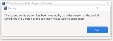

The first message received:

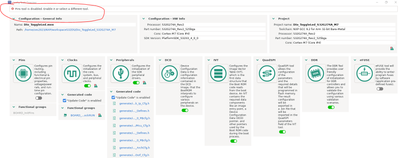

After clicking "Ok" configuration tool displayed error "Pins tool is disabled. Enable it or select a different tool":
I enabled it and opened.
But it shows the following error:

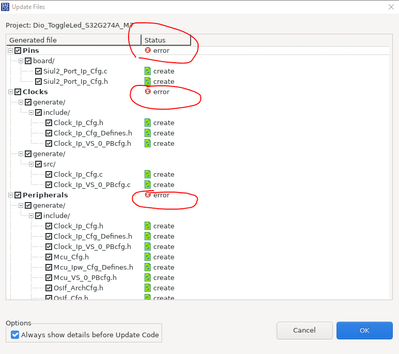

Appropriate to your recommendation I ignored it and clicked to "Update Code".
The list of the files for generation displayed with errors:
I clicked "Ok", but errors notification still displayed:

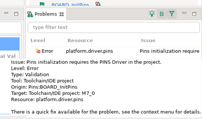

The Pins error is the same as I notified before - resource "platform.drivers.pins" is still absent.

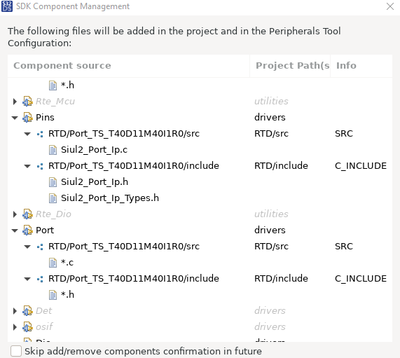

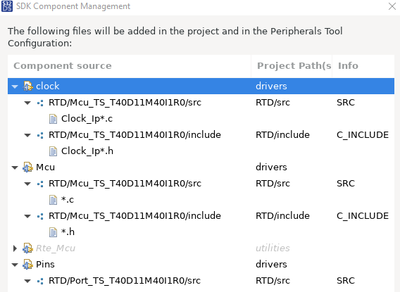

I should add manually by clicking to
The tool suggested to install 5 packages:
- clock
- Mcu
- Pins
- Port
- Dio
VadimIdelchuk_6-1710258559656.pngVadimIdelchuk_6-1710258559656.pngVadimIdelchuk_7-1710258598884.pngVadimIdelchuk_7-1710258598884.pngVadimIdelchuk_8-1710258634888.pngVadimIdelchuk_8-1710258634888.png

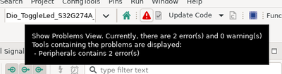

The number of errors in errors notification reduced to 2:
I opened Periferials tool for looking the errors:
I solved them like in previous times by updating Published information SwPatchVersion to 1 from 0.

Thanks for your feedback. The behavior you are seeing after uninstalling the RTD is correct, since Config Tools will not have any reference to the RTD version the *.mex was created for.
As for the installation steps, we see that you uncheck the following items:
You should not uncheck these items. All items from each respective section should be selected.

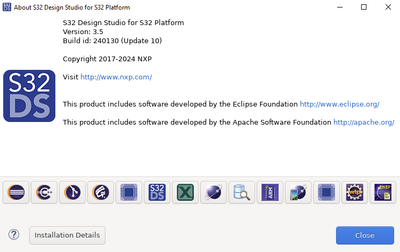

The version of S32DS is
The versions of additional S32 packages are:
