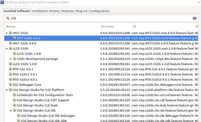

After removing the suggested package RTD S32 The following is list of S32 packages installed:
And opening the configuration tool creates the following message:
and configuration tool no starts.

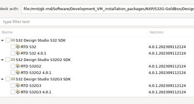

I downloaded RTD 4.0.1 pacakge as ZIP file and opened it to folder.
While I start to install the package, the following installation details displayed:

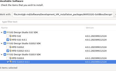

Appropriate to you suggestion I installed only packages with version 4.0.1:
And after installation the list of installed packages looks:
But the same problem with opening configuration tool occurred:
What is the next step?

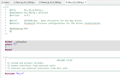

From our side we are not seeing any problems as the ones you are seeing, since we see the files have code under them:
DanielAguirre_0-1710253622955.pngDanielAguirre_0-1710253622955.pngDanielAguirre_1-1710253638606.pngDanielAguirre_1-1710253638606.pngDanielAguirre_2-1710253651344.pngDanielAguirre_2-1710253651344.png

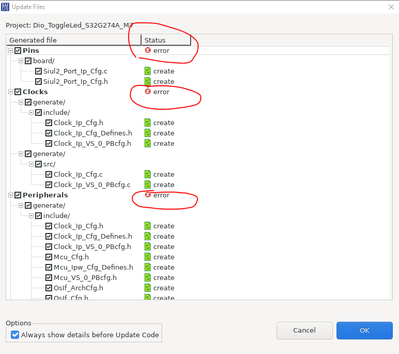

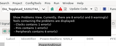

VadimIdelchuk
Hi Daniel-Aguirre,
Thank you for the fast answer.
Appropriate to your suggestion I re-created the example.

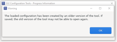

After this I opened configuration tool by double clicking to MEX file.
The first message received:
After clicking "Ok" configuration tool displayed error "Pins tool is disabled. Enable it or select a different tool":
I enabled it and opened.
But it shows the following error:
Appropriate to your recommendation I ignored it and clicked to "Update Code".
The list of the files for generation displayed with errors:
I clicked "Ok", but errors notification still displayed:
The Pins error is the same as I notified before - resource "platform.drivers.pins" is still absent.
I should add manually by clicking to
The tool suggested to install 5 packages:
- clock
- Mcu
- Pins
- Port
- Dio
VadimIdelchuk_6-1710258559656.pngVadimIdelchuk_6-1710258559656.pngVadimIdelchuk_7-1710258598884.pngVadimIdelchuk_7-1710258598884.pngVadimIdelchuk_8-1710258634888.pngVadimIdelchuk_8-1710258634888.png
The number of errors in errors notification reduced to 2:
I opened Periferials tool for looking the errors:
I solved them like in previous times by updating Published information SwPatchVersion to 1 from 0.
The error notification shows absence of errors:
and "Update Code" required.

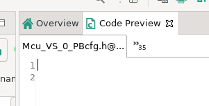

I clicked "Update Code" and preview shown that known problematic files (Mcu/Power/Ram)_VS_0_PBcfg.h will not be generated again.
I canceled the code generation and found that these files are empty.
Is it possible to sign that code generation will generate all files, not only changed or missed?

Daniel-Aguirre
Thanks for your feedback. It seems that there is a mistake under the steps being followed for using the Dio example. Since the Dio example is an AUTOSAR example, the usage of pin tools is disabled since it is not used by AUTOSAR.
When you enable the pins tool, it might be creating a problem since you are mixing AUTOSAR and non-AUTOSAR configurations. We can recommend looking into the below HOWTO's examples, in which some differences are shown differences between AUTOSAR and non-AUTOSAR projects:
If you want to use the Pins Tool, help us using the non-AUTOSAR example "Siul2_Dio_ToggleLed_S32G274A_M7".
Please, let us know.

Daniel-Aguirre
Thanks for your feedback. The behavior you are seeing after uninstalling the RTD is correct, since Config Tools will not have any reference to the RTD version the *.mex was created for.
As for the installation steps, we see that you uncheck the following items:
You should not uncheck these items. All items from each respective section should be selected.
As for the last error, seems to be that the installation was done incorrectly.

Daniel-Aguirre
From what we are able to tell, it seems that the RTD was not installed correctly, since we are seeing that a package is missing on your setup. Below an image from our setup:
Can you help us reinstall the respective RTD package? First you are required to uninstall all RTD dependent packages (from what we can see, should be LLCE and IPCF) to uninstall the RTD correctly. Once done, you can reinstall the RTD package.
Once reinstalled, help us verifying the example is working, since you are not required to have the LLCE nor the IPCF package for the Dio example. If successful, then you can proceed to install the additional packages.
We apologize for the inconvenience.
