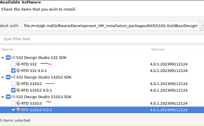

I downloaded RTD 4.0.1 pacakge as ZIP file and opened it to folder.
While I start to install the package, the following installation details displayed:
Appropriate to you suggestion I installed only packages with version 4.0.1:
And after installation the list of installed packages looks:
But the same problem with opening configuration tool occurred:
What is the next step?

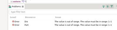

The next problems were in Published information of Dio and Port configuration - the SwPatchVersion of both defined as 0. but required 1.
I change both to 1 and no errors detected.

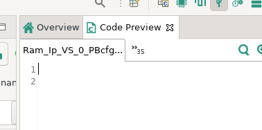

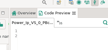

But compilation failed because include files
- Mcu_VS_0_PBcfg.h
- Power_IP_VS_0_PBcfg.h
- Ram_IP_VS_0_PBcfg.h
are empty:
What can be a problem?

I clicked "Update Code" and preview shown that known problematic files (Mcu/Power/Ram)_VS_0_PBcfg.h will not be generated again.
I canceled the code generation and found that these files are empty.
Is it possible to sign that code generation will generate all files, not only changed or missed?

Daniel-Aguirre
Thanks for your feedback. The behavior you are seeing after uninstalling the RTD is correct, since Config Tools will not have any reference to the RTD version the *.mex was created for.
As for the installation steps, we see that you uncheck the following items:
You should not uncheck these items. All items from each respective section should be selected.
As for the last error, seems to be that the installation was done incorrectly.
Please, let us know.

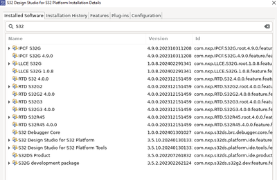

VadimIdelchuk
The version of S32DS is
The versions of additional S32 packages are:
5,225 Views
Daniel-Aguirre
From what we are able to tell, it seems that the RTD was not installed correctly, since we are seeing that a package is missing on your setup. Below an image from our setup:
Can you help us reinstall the respective RTD package? First you are required to uninstall all RTD dependent packages (from what we can see, should be LLCE and IPCF) to uninstall the RTD correctly. Once done, you can reinstall the RTD package.
Once reinstalled, help us verifying the example is working, since you are not required to have the LLCE nor the IPCF package for the Dio example. If successful, then you can proceed to install the additional packages.
We apologize for the inconvenience.
